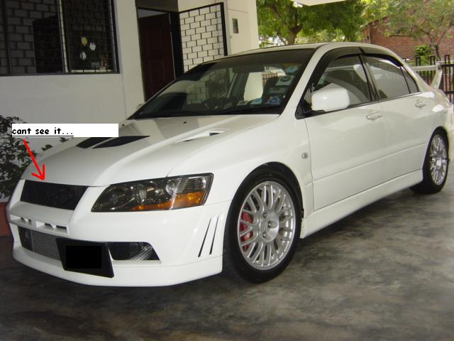

ARVSHOP,

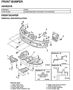

Wow, clean~! What do you mean? You just use adhesive to stick on to the original bracket that is provided on the front grill? Everything looks clean, now you'll have to realign ur bumper as your sides (whereby the bumper is bolted and clipped onto the front fenders) are slightly out and what CF bonnet are you on? Am not sure bout u, but I noticed that all CF bonnets on the VII front facia are slightly misaligned. From your front and side pics, you can see your inner bumper (in between your bonnet and top upper bumper where u fix the cooling plates) can be seen. If you look carefully, if you had the original aluminium bonnet fitted, it will fit perfectly and that top part of the bumper is not visible. I noticed this once i fitted my CF on. I tried swapping to lower rubber stoppers but it still shows. See from the pics i've posted, you know its very tacky! I have also attached the diagram for installing the rear emblems of the EVO VII to you. Will look true JDM if you had those amber signals on your front headlights.
lil evil evo,
The front and rear emblem are of the same size, only that the rear is sticked on using adhesive/double sided tape and the front has two hooks and a screw hole for you to hook and screw onto the original bracket. You can see from the attached illustration that I've attached.

Hey notiguy, to be honest man when I received the bumper, it was completely messed up. the metal supports were all bent, parts of it have been chunked off, and the grills were all bent. It came from a car that was totalled and it's amazing how we were even able to make it look brand new....(trust me it took 2 weeks for the body shop to fix it...gladly it's my uncles so i didnt have to spend a penny) ....if you knew what we had to go thorugh to even make it look like what it is then you would understand. It's not like i just bought the bumper and the hood and got it painted and finally installed it...It was a lot of hardwork and planning and salvaging, researching, etc. see you're lucky because there in malaysia evo 7 parts are not hard to comeby...here in US everything is priced so ridiculously it's not worth converting to the 7.... as far as the "misalignments" it was so hard to find an evo 7 hood and Seibon happened to have the ONLY one. when we installed it, it WAS HECKA OFF... we had to improvise and make modifications for it to even fit....maybe you might be thinking "wow it wasn't worth it then".....well to the people that spent the time to work on it and finally get it to where it is now is a huge accomplishment. hehehe yeah i just notcied that the VII on the rear emblem is too clos and will fix that as soon as there is time....thanks for the heads up on everything and I'm VERY HAPPY TO HAVE AN EVO 7!!!!!

Gosh, you mean the so called 'crashing bar' was bent? Now if the original grills were bent, i know how you feel fixing those back... its a b$%^&. My friend bought a reconditioned unit recently, and i tried getting it back to it original look, boy it was tedious and couldnt get it near 70% of its origin. The misalignments I was mentioning earlier was the sides of the bumper bolted and clipped onto the fenders. As for the misalignment of the hood and top part of the bumper, I know that for sure it will not fit like stock. Even my original HKS Kansai bonnet doesnt fit perfectly. I'd guess its the heat that the engine generates that pulls the resin back... and moreover for me, i live in a 30degrees everage throughout the whole year with heat and rain, what will not give way? I should have taken a photo of my VII's tails, it was pink!
