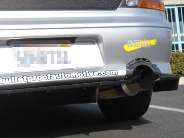

Not true, there is a Varis rear diffuser for both the EVO 7 and 8. On the EVO 8 version, you need the JDM rear bumper for it to work.
www.varisusa.com <--- US distributor website

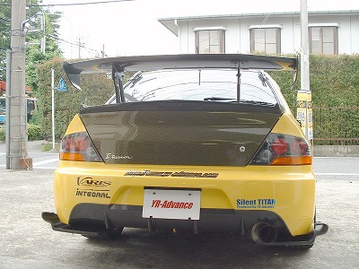

I'd like to know what exhaust is on the yellow evo here. thanks!
Old Nov 19, 2005 | 10:53 PM
  #39
trinydex's Avatar
Posts: 6,072
Likes: 8
From: not here
jic spartan ti

Varis Side Diffusers on EVO9 rear bumper
