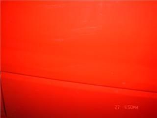

ok i'm about to buy a red evo9 n there is a slight blemish on the passenger door.. lil 2-3 tiny scratches from some other car door that barely scraped the evo door.. is it hard to get blemishes out of the mitsu paint.. i keep reading how alot of people have probs with their paint.. just wondering.. thanks!!!
might be hard to see but there it is.. also do those touch up paints from mitsu work well with like rock chips?? there is one lil one on the fr. bumper!

If you can feel the scratch with your fingernail it won't come out. If not a good compound or polish and an orbital will murder that thing. As far as the touch up, you have to prep it good to get a good result. Check out Autopia.org for this.

as for the paint what redline said was spot on, good luck
