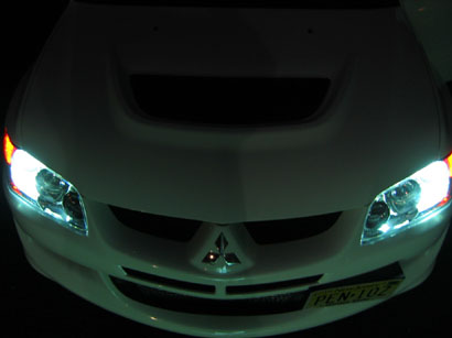

Does any of your HID turn yellowish after 15sec or so after is turned on? I have seen video on the evo8 wit the headlights on and it seems much brighter than mine. When i turn on my headlight...it seems to be really bright and white for about 10 to 15 sec....and then the color start fading to a yellowish color (like regular headlight) I wanna know if this is normal or is just mine.

this is how it look when it first turn on....

and this is after about 10 seconds....

thats the way HId works....The purple color is just the warm up stage,and it will stay yellowish afterwards,but the color output will be bluish/purple white color depends on the angle...

Looks normal to me. The Evo color temp doesn't seem as blue/purple as some of the European cars.

I believe the HID that comes on the evo8 is ~4300kelvin. The bluish version is about 6000K and the purplish version, which is in most bmw and mercerdes is 8000k. These value are for fully warm up..15secs after turn on. Generally, the higher kelvin rating, the better it looks, but brightness is sacrificed.
The purple on the edge of the light beam is caused by diffraction of the light passing thru, the same reason you see rainbow when its raining.
To onetOnsoup: your light looks ok. just compare the light from the 2 headlight, if one looks a different color from the other, then you should start suspicious. These bulbs have very long life, might last as long as the car if its not abused.
