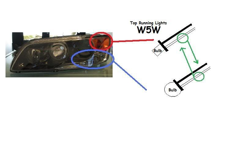

just got done doing the rewire for the H11---->9006 Foglight conversion as well as i swapped the Driving light so that the Amber would be lit and the turn signal is on top.
The amber is so bright that you can not really see the turn signal.. But it looks alot better...
Let me know what your guys think.
For those looking to do this there self. The wires share a ground wire which is spiced.. The other wires are the 12v Signal wires. Cut and swap the wires. How you do it is on you.
