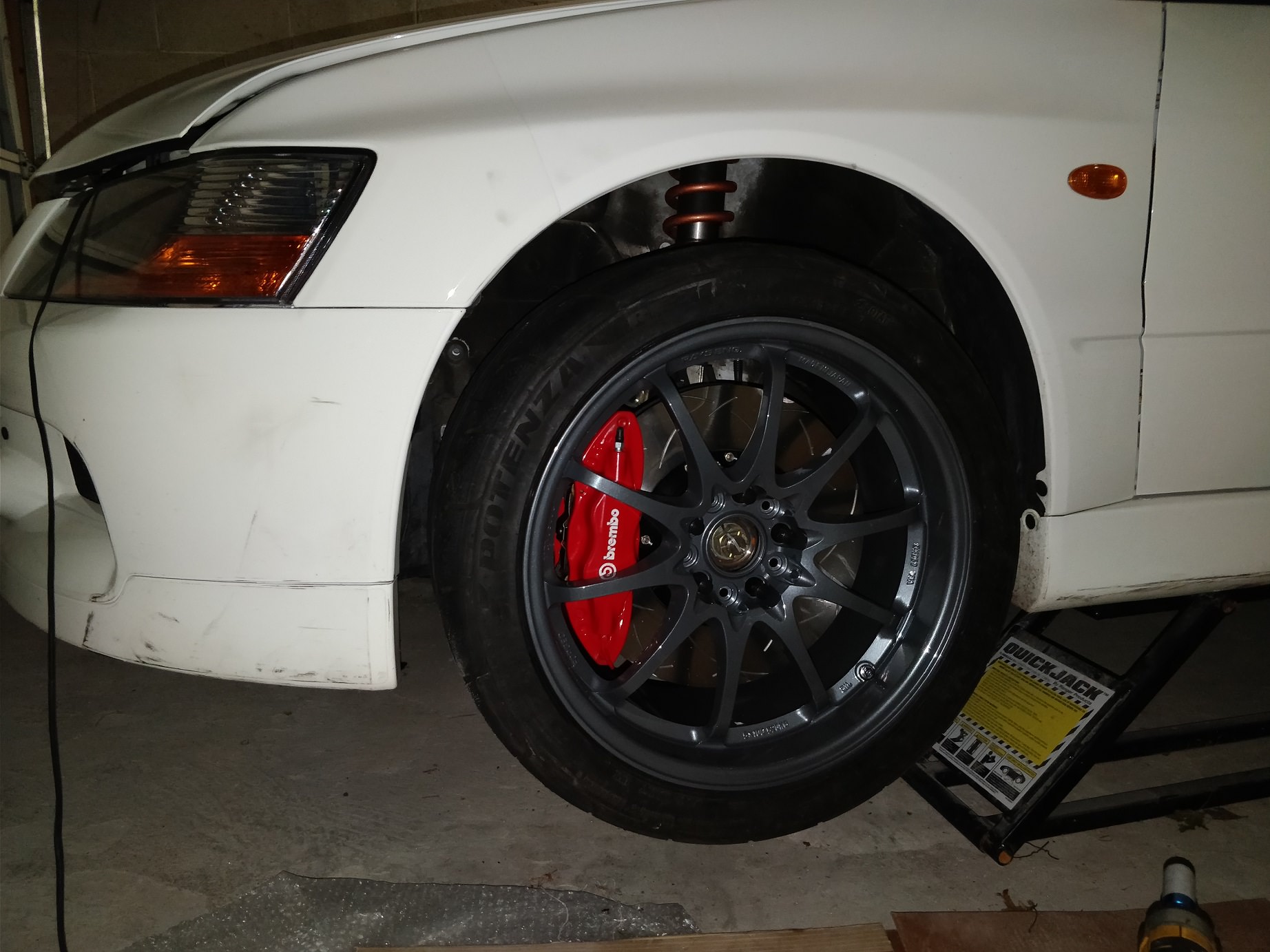

adding some pics of my new wheels! it's very different depending on the lighting, but overall really happy with how they turned out!
Attachment 324917

That wheel end is pure eye candy

Oh, and those wheels look really good! I'm a big fan of greys and charcoals.

thanks - it's a little more blue than i thought it'd be in a few shades, but overall not bad.
and yea, the powdercoating company said a big use for powdercoating was for anti corrosion and that a ton of wheels on the market today are pc'd without people being aware of it
