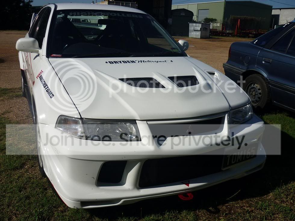

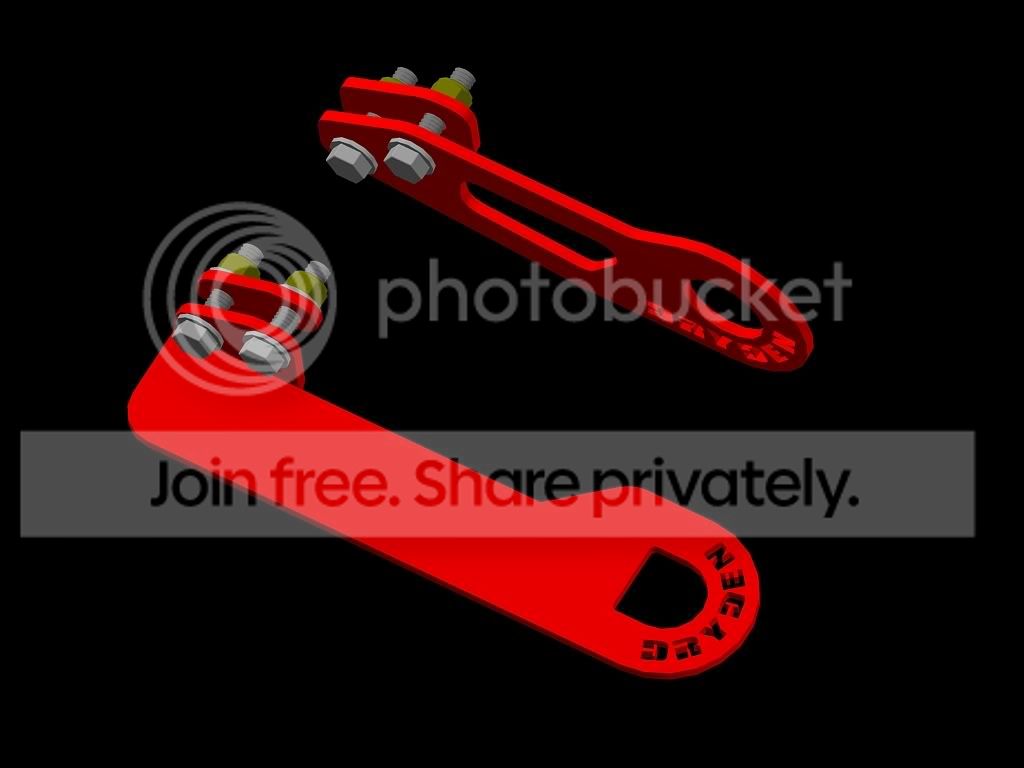

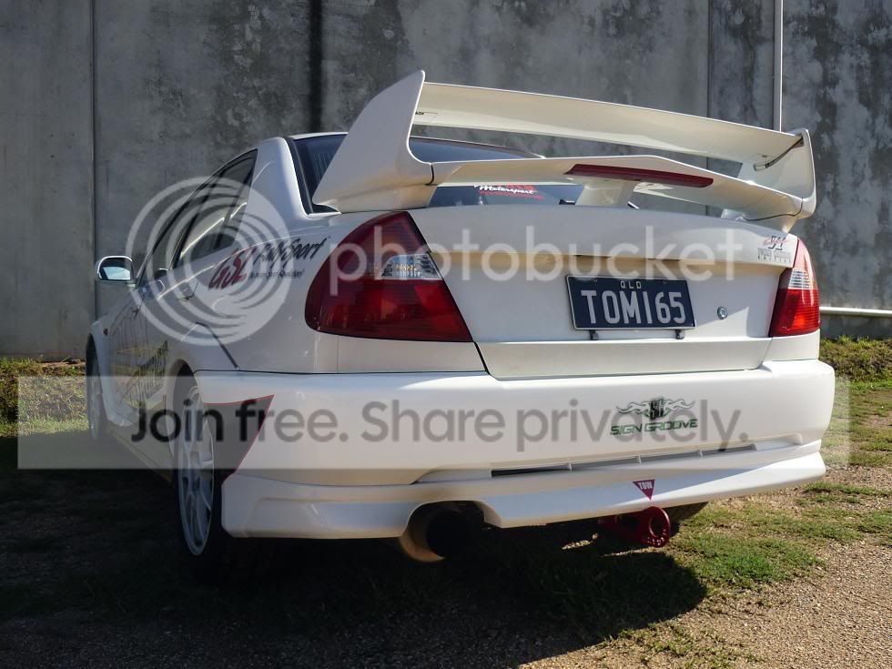

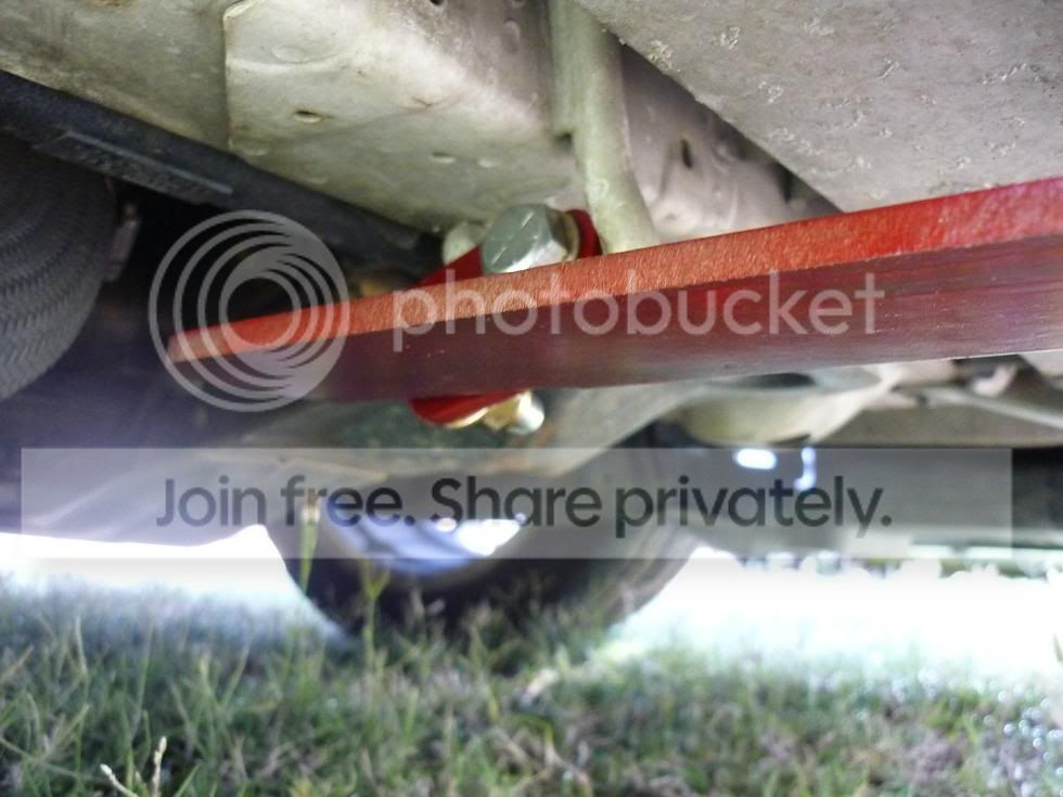

Well I have been searching for ages for tow hooks to suit an Evo. After ages of not finding anything and with work fairly slow I decided fock it I will make my own! Using the same mounting as all the Honda tow hooks (also found one DIY of an Evo using this method) I was able to come up with this... Basictly you use two bolts to sandwhich the tow hook onto the existing tow point. One goes in the loop the other outside againts the point. These hooks allow a more visible and more accessable way to tow your car (great for if you need towing at the track). My hooks are laser cut which i drafted myself. anyway pics talk.
Rear
Front

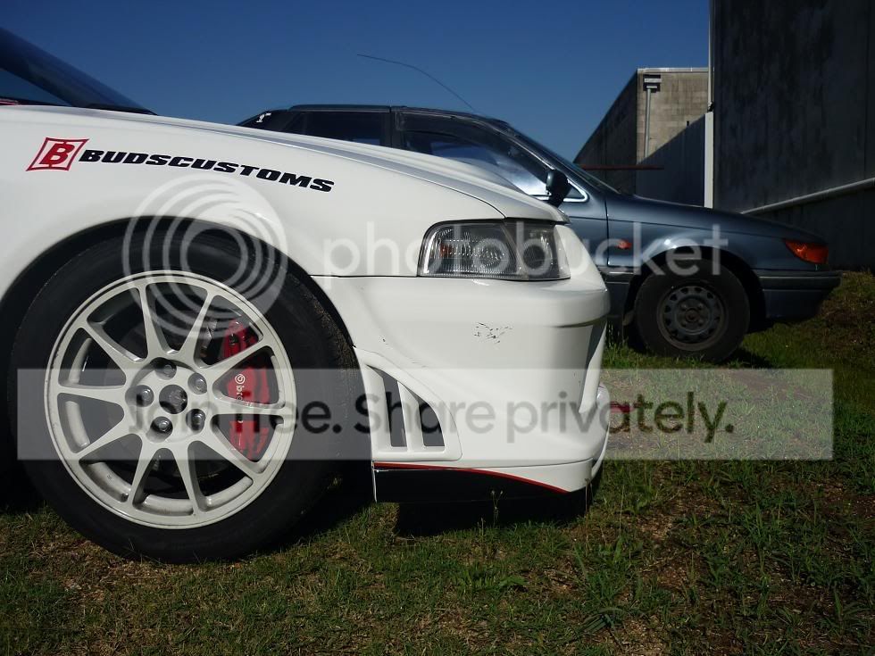

and a pic of my car in street trim when its clean haha

Originally Posted by Billy@EnglishRacing
The car looks great! Do you have any pics of the car in race trim?
yeah i do

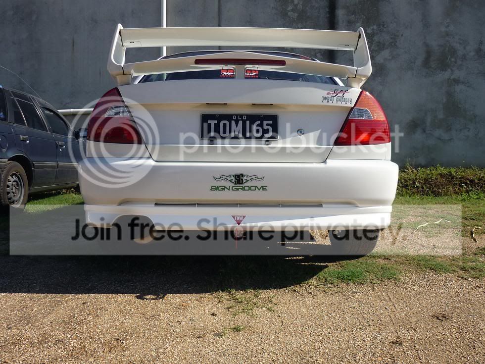

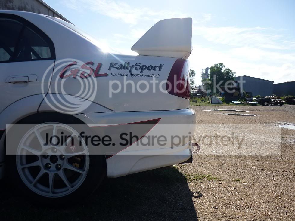

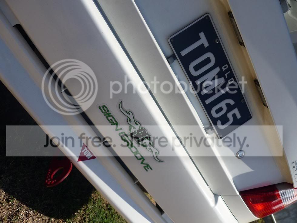

one on a customers car
