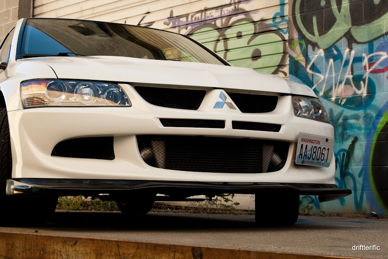

I bought this lip for my car and the fitment was really good.
http://cgi.ebay.com/ebaymotors/EVOLU...Q5fAccessories
I should have taken the bumper off when I installed it so that it wouldn't dip down a little bit in the front. Im going to pull it back off to get it painted so I will fix the gap when I put it back on.
http://lh5.ggpht.com/_aWyqIrqsEVQ/TG...0/IMG_3412.jpg
