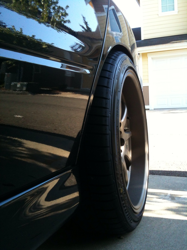

Sneak peak of the new set up, better pictures onces I get a photoshoot!
Works XD9 18x10 +18 on 265/35r18. Tucking the fronts, just rolled fenders! :O

Lets see the rears... this ought to be interesting.
You should've bought the 18x10+38 XD9's... they would stand a way better chance of fitting in the rear.

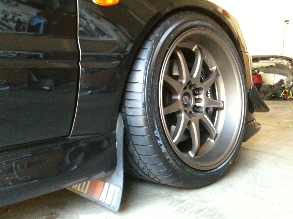

No issues on rubbing and my rolling isn't even aggressive yet. But I did have to -3.5 front and -3 in the rear. lol

Hard to have rubbing issues when your car just sits in a parking spot. You can actually see on the tire where it's rubbing. You're full of ****. Wait until you get on an on ramp with someone or something in your backseat.
If you lower it more you can get more camber. I doubt you're achieving -3 degrees of camber in the rear at that ride height without adjustable camber links. Just saying. best of luck!

I am at that because I do my own alignments and maxed out the specs front n rear. I wouldn't let anyone ride in the rear anyways because I know for sure it will rub.
