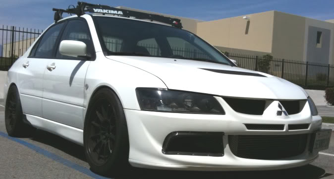

Sorry for the crappy pic.
18x9.5 +27 NTO3s w/ 10mm spacer up front
265/35
-2.4f & -1.4r
..still need to roll rears, but fronts are ok, but will probably roll anyway...
