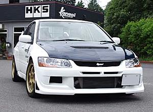

i think the headlights are different, same size but the corner lights are on differnt sides or something like that.
Old Dec 30, 2003 | 09:10 PM
YellowFever's Avatar
iTrader: (24)
Posts: 1,511
From: Clifton, NJ
the amber lights are on the bottom like this:

Thanks everyone 4 there help and info, learned more about what I need to do.
Any more input is welcome of course
Btw, YellowFever, what kit is that?
Old Dec 30, 2003 | 10:02 PM
9th_spec's Avatar
Posts: 106
Ahhh it says on the background of the pic which is HKS Kansai.

^ exactly what he said
