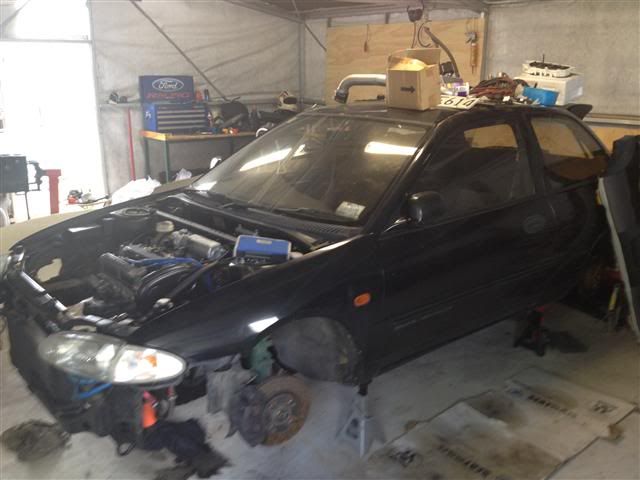

Some more pics as requested:
The body does need some minor repairs here and there, the bootlid (trunk lid for you lot?) has some rust where the wing bolts to it, some minor dents to the drivers side front guard/fender and you can see the front bumper sags a bit on the drivers side.
The factory recaros have seen better years, I may fit my Sparco Evo 2 race seat and just replace the passenger side to tidy it up. I already have an Evo III rear bench to go in.
The Tommi rims which will share duties with some Enkei Tarmac Evos.
Sold off my DSLR a few weeks back so i'm reduced to taking pics with my iPhone, also featured is my CC4A 4WD Mirage racecar in the foreground. Another pic below. Will be building this as a basic club level motorsort hack in a few years time, tarmac sprints, hillclimbs etc etc with a simple 2L setup.
