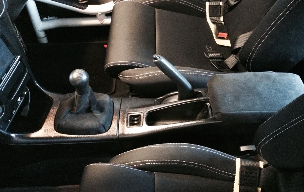

Beautiful V! Tell me more about that shift boot cover! I couldn't find any V shift boots when I was looking so I had one custom made out of Alcantara. That Sparco one would go good with my seats though!

Attachment 226818
Yeah same! Couldn't find an option so just got a universal one from Amazon and had it shipped down. I like your alcantara version though, I wanted to do that originally.

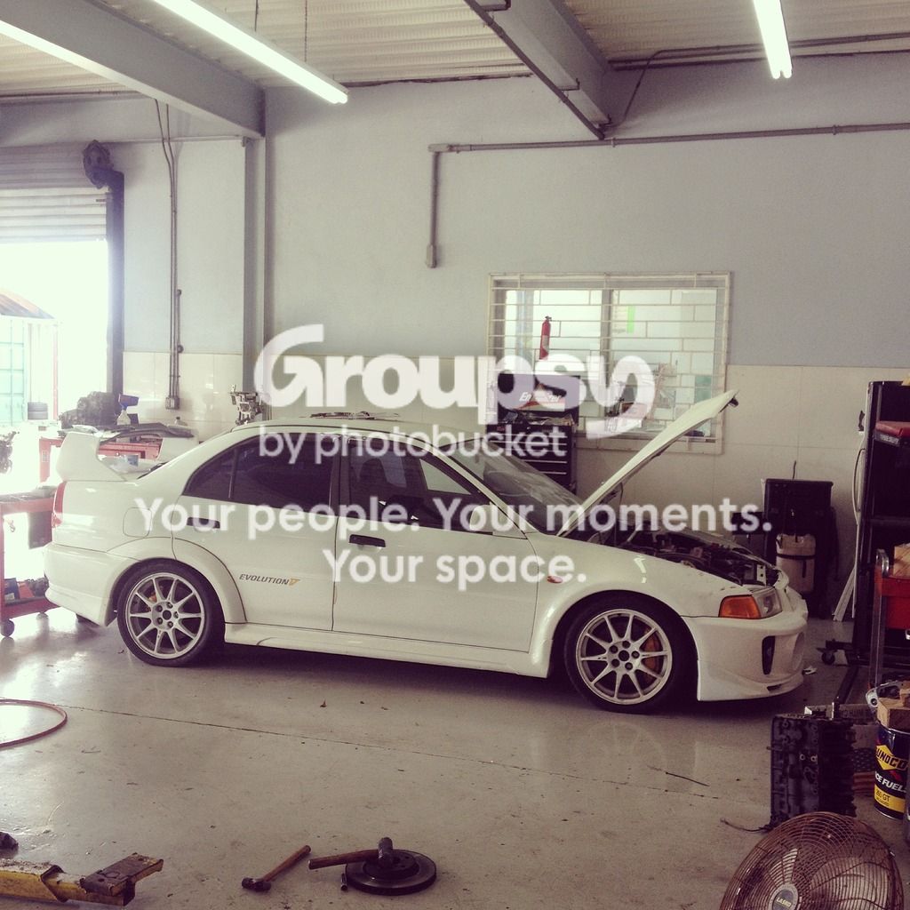

Where to start....
Been AWHILE!
(The very condensed version)
Got around to fixing my brakes...Installed a Stoptech sports kit. Rotors, pads, lines.
Brakes Soooo good now.
Slotted rotors
Changed timing belt etc and wired in an Evo8 AEM Series 2
I 'borrowed' my friends carbon wing insert (still haven't given it back, hahaha karma??) After driving around I started to hear this nasty clunk when making right hand turns. It violently pulsated through the steering wheel as well.
Turns out if you have an Evo 5/6 with the factory front LSD its common for the diff bolts to come loose and eventually get sheared off. Perfect!!
After weeks of waiting, I finally got the $12 bolts or whatever they costed back into the gearbox and was handed a nice fat bill. I need to learn how to become a mechanic very quickly.
Taunting me.
"Picked up" a set of Kelford 272 cams and supertech springs and retainers and left it to be fitted up. Removed EGR, fitted a Tial bov, spoolinUp COP, manual boost controller and replaced a bad wastegate actuator. I know there is no filter, its a pile of junk and keeps falling off, so I just leave it off. I need to relocate the battery to the trunk so I can make room for my speed density intake with filter.
Nothing seemed to be going right, after a 3rd gear pull the car shut out. Started it back up and it started misfiring. It seriously sounded like a Subaru. After some troubleshooting we opened the valve cover to find a snapped valve spring.
Kiggly Beehive springs and retainers, and gsc zero tick lifters were ordered then after more waiting, finally got those installed. Another bill again, woohoo!
All of that behind me, it was so good to drive again!
But it was too good to be true....
I'm now getting a knocking sound coming from the motor, not sure what it could be..
Trials and tribulations of Evolution owners!
