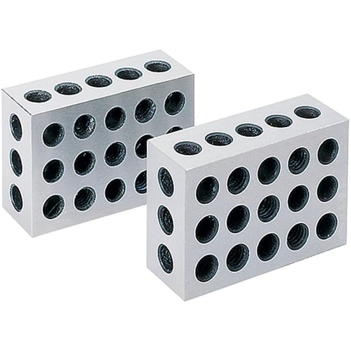

To compensate for that problem of having 3 scales level and the 4th scale not level, i have come up with the easiest solution for you.
1. Once you have measured the wheel bases front to rear and side to side, place the scales on as level as possible ground you have to work with.
2. Level the scale plates with the scales in them using the bubble gauge.
3. Go to Home Depot or Lowes or what ever home inprovement place you have in town and buy the longest level they have (probably a 6' or 8').
4. Go to your local machine shop tool place and by these 1-2-3 blocks, they will help you for making sure everything is level. Im sure you can get these from any tool machine shop.
http://ec2.images-amazon.com/images/...V65957033_.jpg
5. once you have these partsplace the 1-2-3 blocks in the middle of the front pads, using the 6'-8' level place it on top of the 1-2-3 machined blocks and do your finally leveling adjustments on the front pads.
6. same as step 5 just on the rear pads now.
7. Since the level isn't long enough to reach a front right pad to a left rear pad (crosswise) you might have to use your laser level here.
The only thing i don't like about laser levels is that they tend to move with the slights touch not giving you an accurate measurement if you accidently bump it without knowing. plus the laser like to jump and is very sensitive.
I hope this helps, if not let me know, i have a buddy who Corner weights on the side and he would try to help you understand as well.

I think so but am still a little confused about using the 1-2-3 blocks
Why would i need to use those?
The only thing i can think is that they are measurd flat and i can get the center of the scales level.
Also would having the rears and fronts at slightly(less than a few millimeter) lower or higher make too much of a difference.
As long as the 2 fronts were at the same height and the 2 rears were at the same height then it would be "ok". My guess is that the cross weights would be close, it may not be exact, but if i couldn't level the rears and front to eachother then at least my cornerbalance shouldn't be too off right?
