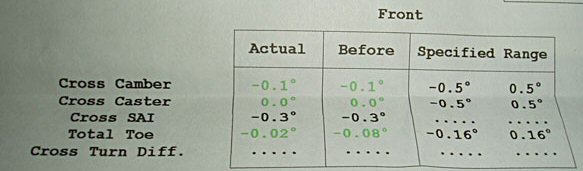

Stock Evo alignmnet settings
I found my pic's of stock alignment settings
I believe these are from Mitsubishi, if I can find my DVD of Evo repair manual I will double check'm
Attached Thumbnails alignment problem... again-front-alignmnet.jpg   alignment problem... again-rear-alignment.jpg

I had this happen as well. Ended up rotating the tires to get the inside edge switched out, the toe was something like .20, which is way off. Stock toe spec is +/- .08 and Camber is -1.5F/-1.0R. I ended up doing 0.00 toe all around and -1 camber all around for a little longer tread life. If you want better handing, increase the neg. camber, but it will shorten the tread life.
