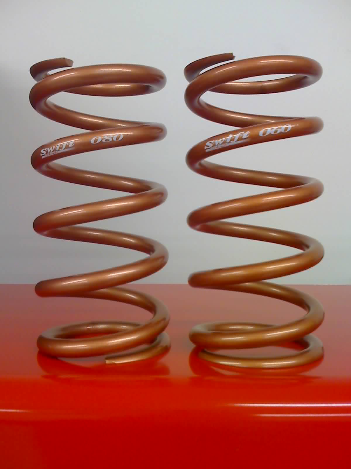

Here are the springs we are working with. They are the same springs U2SLO aka Pete is running now. Swift springs 7"oal, 6kg, 8kg, 65mm id. This is our starting setup and will be reducing rate as needed for drag racing.
