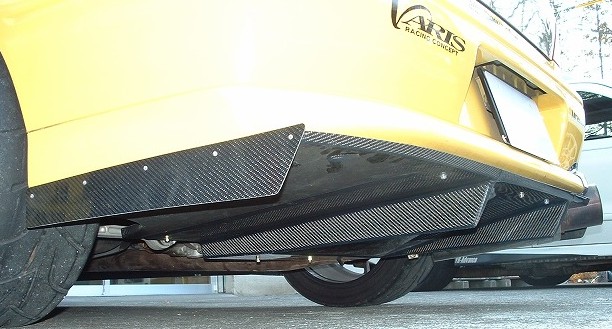

Gruppe S has this one. I think it looks good.
http://www.gruppe-s.com/Evo/evoext.htm

that is a better pic of the same under pants

Hadn't seen that, what thread is that from? and who makes that? Also why is it not compatible with the USDM Evo? US's longer rear bumper?
