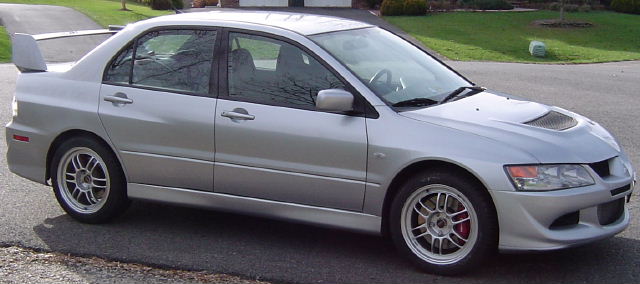

Wheel: Enkei RS-5
Size/offset: 17x7 5-100/114 40
Price: ~140$/wheel from Discount Tire
These are a 5 spoke design. I was surprised that a 17x7 wheel fits, but it does. Clears calipers by a mm or so. I drove around with the windows down to make sure it wasn't rubbing when turning or braking.
I'll add some weight info as well. On my bathroom digital scale, the stock Enkeis with ~60% worn advans and lots of brake dust weighed 44 lbs (no lug nuts). The Enkei RS-5 with brand new 235 45 17 Falken Z1-EX all seasons weighed 43 lbs.
Here is a pic on my car:

Per jbrennan's post here is more info:
Hubcentric rings were required and provided by DiscountTire in my case. Also provided were gorilla lug nuts.
</edit>
