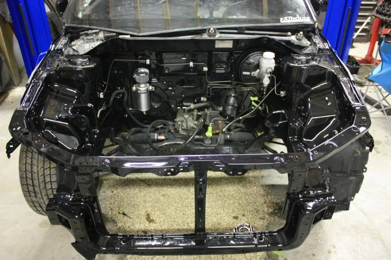

I have a MR and I'm went to a RS brake master cylinder. I just need to know what lines coming off of the master cylinder go where. What do the bottom two go to and the top. Also where did they put the proportioning valve as well?

the valves are in the same place as the pic displays (the two on the bottom of the master cyl), as for where the lines lead why not just order rs brake lines and figure it out then? they are hard lines and only go on one way. not trying to be a know it all, just curious. you using ss braided lines?

Well I'm running my own hard lines I'm a different location. I'm doing a wire tuck and repainted my firewall so I want it to look clean and try to hide them as much as possible.

ooh i see what your doing, so you need to see where the lines go for custom lines, would this be what you're looking for? the two bottom ones with proportion valves attached go to the rear, the top one goes to the right side and the left one sticks to the left.

Yes thank you just found this out like a hr ago from another member.
