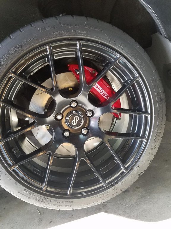

Finally got around to buying the rear kit to match the front StopTech kit I bought in 2012 (wow time flys!)
Love the fit and finish of the kits, not one problem with the front kit after more than 80k miles (this is my daily/commuter car) The paint on my front kit still looks brand new, no fading or blistering like the OEM Brembos. Installation is a snap, I did have to grind the caliper mounting tabs as mentioned in the installation instructions, nothing significant, basically cleaning up the casting flash.
I’ve got the Sport pads on front/rear and they work well for street duty, initial bite is a bit on the lazy side, but once they heat up just a tad, oh-boy LOTS of stopping power. The one gripe I do have with the Sport pads is lots of brake dust, I am thinking about trying the Street pads just to see if it gets any better.
Front/Rear Bias and Modulation is right on with no unexpected drama. It takes a lot of abuse to get them hot enough to fade – Yes I can overheat them, but they are head and shoulders better than the Brembos. Overall I give this StopTech setup a thumbs up.
What I bought:
Front Kit: 83.622.6700.71 (355 Rotors and ST-60 Calipers)
Rear Kit: 83.622.0043.71 (328 Rotors and ST-40 Calipers)
Hope this helps anyone looking at the StopTech kits.
John-
