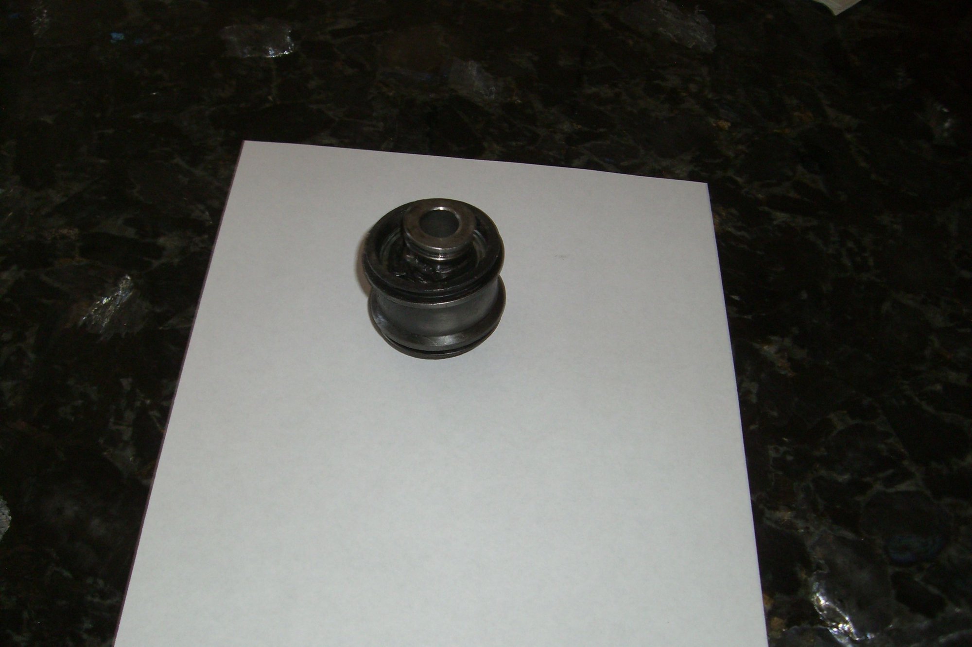

I think youre on the right track. Seems like keeping the more robust OEM spherical might be the best bet. My susp tuner did not want me to change mine either. Unless you were able to locate that Perrin PSRS bush
At the other locations i went w/Whiteline. The ES bushes will be just fine as well
Heres a pic of a torn down EvO large OEM spherical just for reference

I have the ES kit installed and I find it hard to believe the kit is any less robust then that of the stock stuff... The sleeve that slides into the bushing is thicker and more robust then the oem one..
With that said - what about the Whiteline Evo 8/9/X Race-Only Anti-Lift / Caster Correction Kit...
If its a track only car - it looks like these are solid stainless
