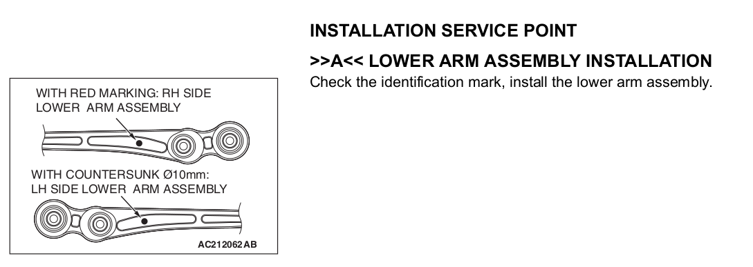

Hello,
I want to ask this simple question, are those identical? Dimensions etc?
Manual is asking for correct ones for left and right.
But, my car has both with the countersunk.
Could someone meassure it please?
Thank you very much

My good guess is that they are different & should not be used on the opposite side! If someone were to move the left to the right you would have to flip it & the there very well could be a difference in the angle.
Im sure the length is the same but but must be used on the side they were designed for
My .02

They are definitely different. Aside from the manual calling it out, they have different part numbers.
https://partsouq.com/en/catalog/genu...&uid=117922&q=
