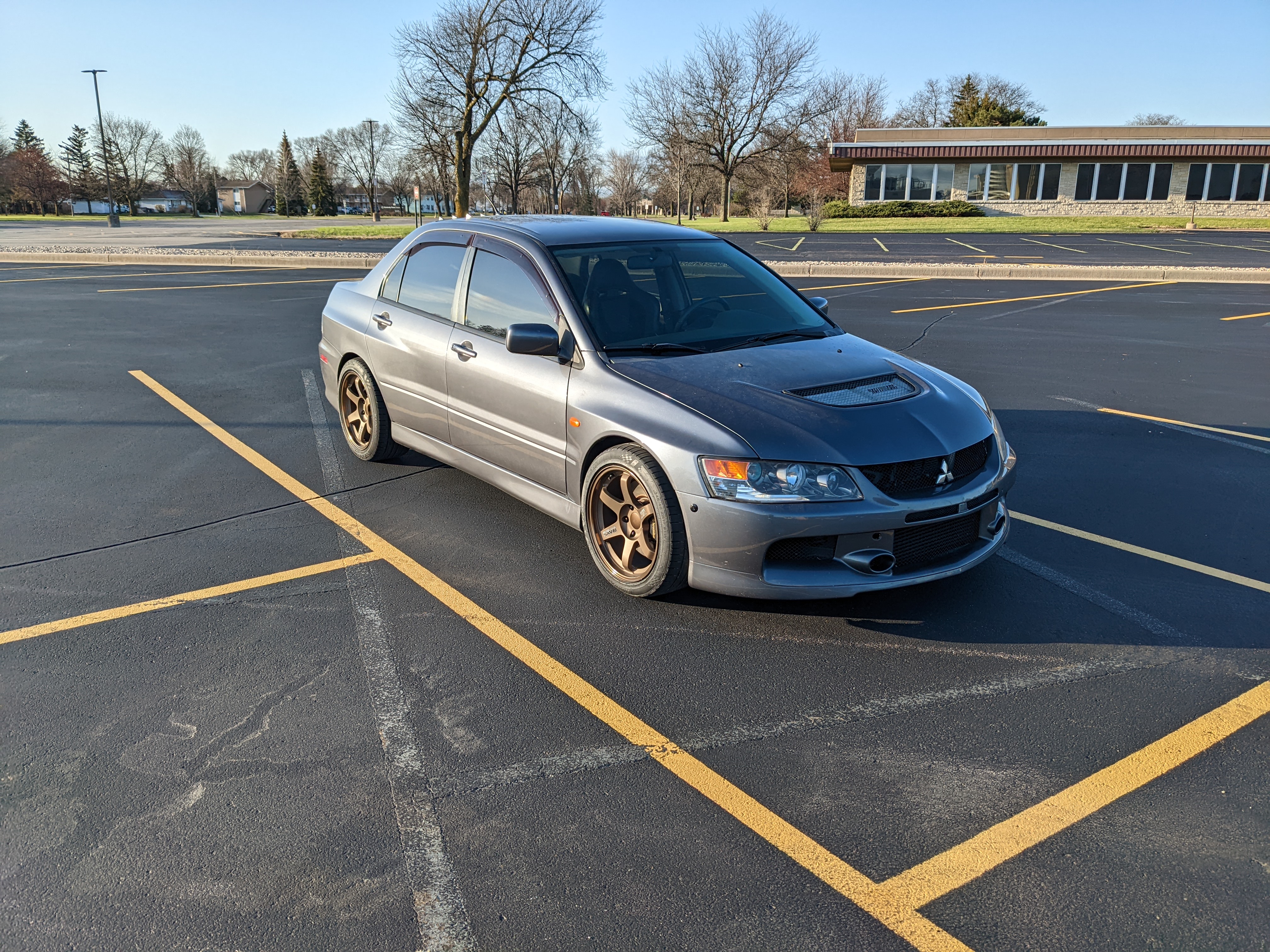

I personally run a 245/40 on a 17x9 +15 and I need a little camber on the rears as well as coilovers to keep from rubbing. The fronts are a little easier but coilovers are an absolute need.
I didn't do anything outside of the factory eccentric on the rear.

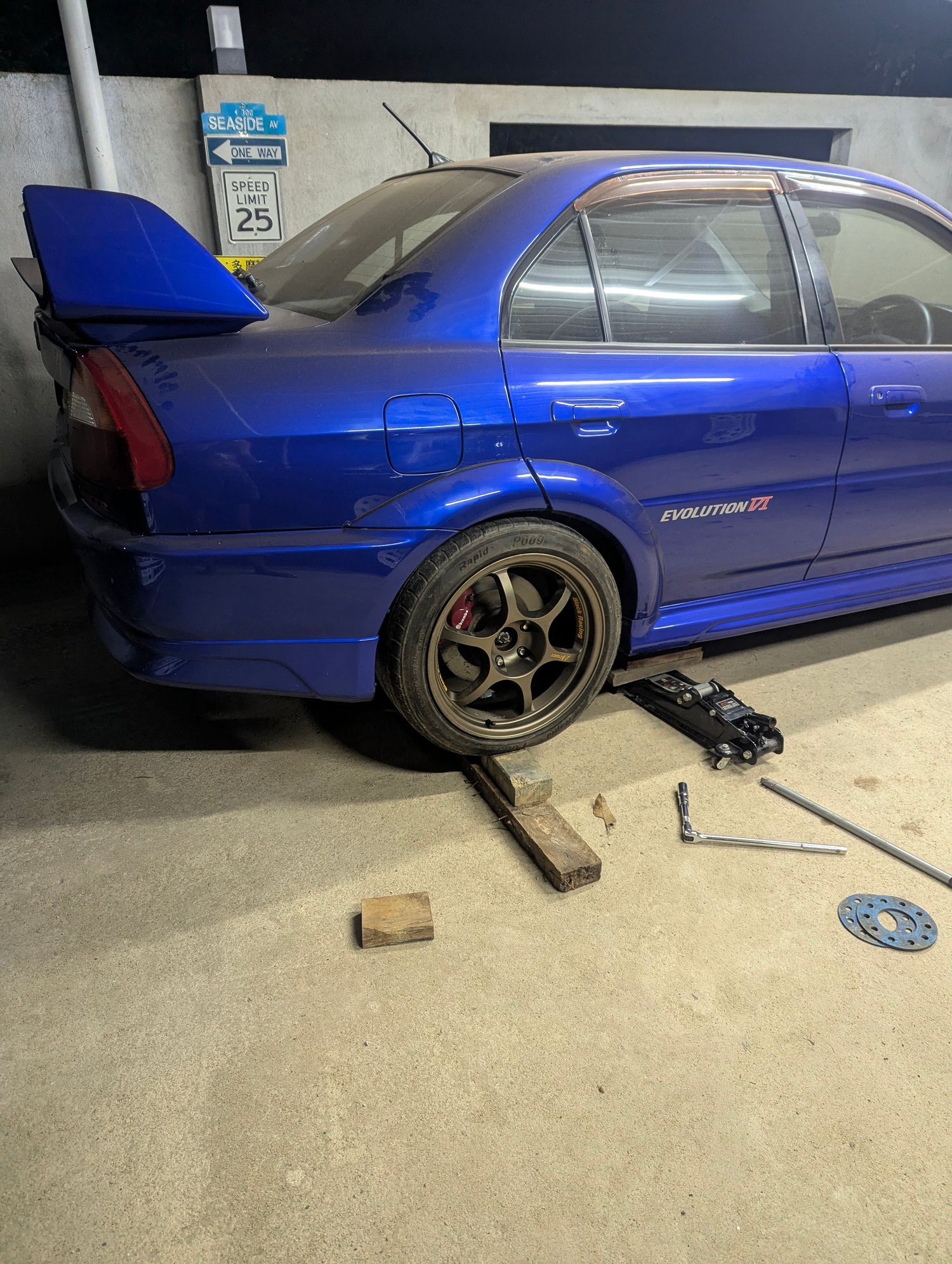

FWIW I run 235s on 17x8 +35s, I am lowered about an inch up front and a half inch in the rear and have no issues at all (Evo 6). Should not be too much of a struggle to get those to fit, but why are you running wheels with that much of a change from factory offset?

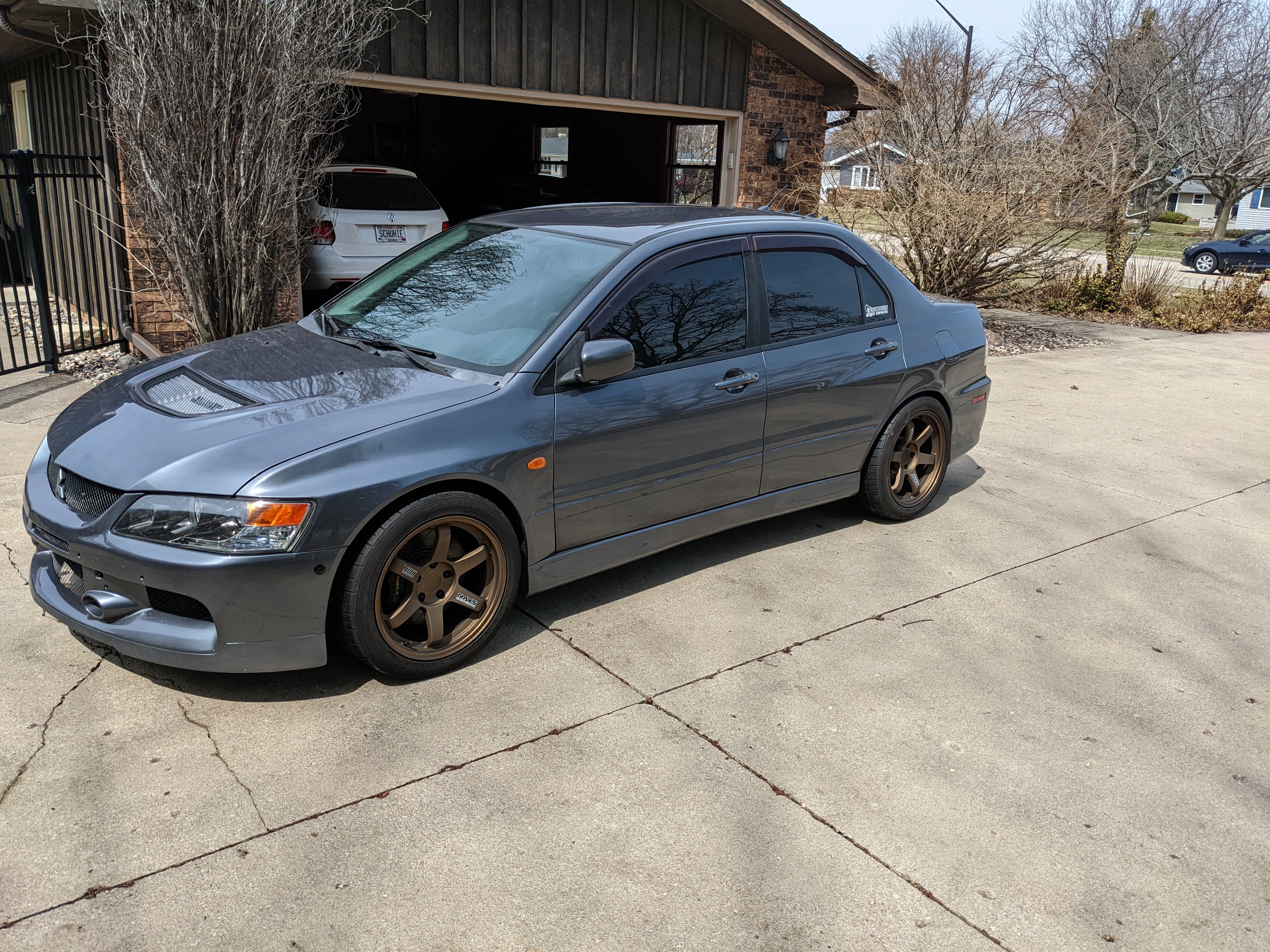

I didn't see that you had a 6. That will make it a little different from my 9 but here are some pictures.
Attached Thumbnails Evo VI 17x9 -245/40-pxl_20220423_165416084.jpg   Evo VI 17x9 -245/40-pxl_20220504_120038956.jpg
