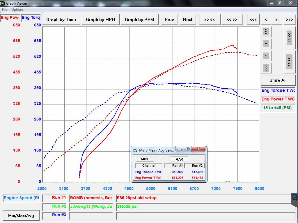

Here we have 2 cars:
id2000
ets 1.9 exhaust manifold
arp headstud kit
Super tech intake and exhaust 1+oversized valves
Kelford valve springs
Aem Uego ( a/f ratio wideband)
ferrea titanium retainer and valve seat locators
Ams Tmp Cams
Built 2.2L
and
Stock Motor
stock manifold
Stock MAF/ETS intake
AMS DP
Catted Mid Pipe
ETS Exhaust and fmic
ID1300
Walbro E85 Pump(267)
Radium Rail and Regulator
5150 Custom fuel lines
E85/91
The charts.........Pretty much Same boost too
Pretty amazing Turbo and hence why i love it so much!!!
the Stock Motor car will get Cams soon and a real intake
and probably make over 500
The built motor will get more boost soon and see over 625....
add 15% for Dynojet numbers though

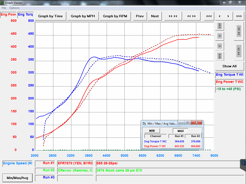

3576 vs 7670

the Stock location GTX3576 spool much faster imho
the 6266 on a 2L are laggy as hell
a 6466 on a 2.2 is still laggy although FUN!!!
for a DD i would use this turbo
for instance here is a 6466 on a 2.2 vs a GTX3576r stock location

Thats my dyno for 28psi tamper to 25psi .
i believe jon will be making a higher boost map soon
