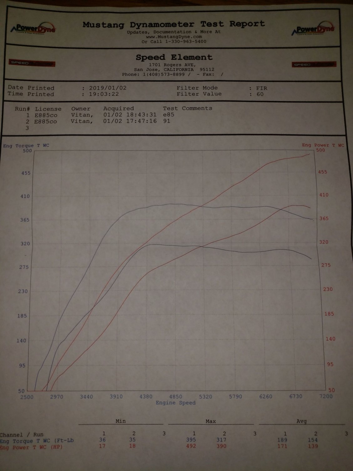

2008 GSR 116k miles
Stock block. Only had timing chain replaced
Tuning done by Gary of Bains Tuning (if you are in the bay talk to Gary)
GTX3071R gen 2 ball bearing
MAP Tubular Manifold
ETS Recirculated DP
Test Pipe
Greddy Evo GT exhaust
FIC 1100 injectors
Wally 450
Bains Tuning Flex Fuel kit with tephra rom
grimspeed 3 port
ETS intake
ETS UICP
MAP LICP
MAP 3.5" intercooler
AEM AFR
Tanabe boost
Misc suspension and wheel stuff blah blah blah
Car idles like stock. The spool and response on this turbo seem stock if not better.

Looks good! Cams would be another good power adder. Like another 30whp.
Reply 0
Jan 3, 2019 | 05:54 PM
I like that torque curve.
Reply 0
Jan 5, 2019 | 05:03 PM
Those are some fantastic numbers!
How is the fuel pump controlled?
Reply 0
Jan 17, 2019 | 09:49 PM
Hello, OEM wiring on a 450 pump.
