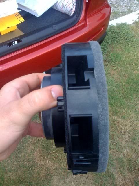

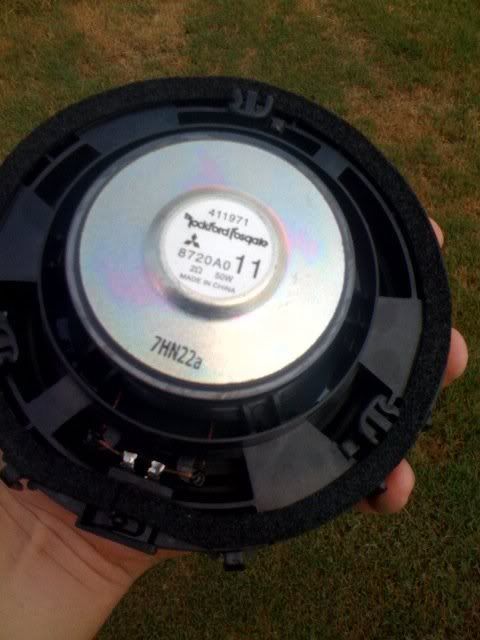

I'm a noob to Evos, but not a noob to i.c.e. So, pls. ignore noob-ish comment about evos. I've got an EvoX GSR.. just got it 2 weeks ago. I can confirm that the "dealer-installed" speakers S.U.C.K. I've been trying to find information on things like mounting depth of the front speakers, and the rear speakers, and the diameter that it can fit in.. etc..etc.. I've got these pics of the adapters for the front speakers (courtesy of a forumer, but I can't remember which forum.hheheh)... I can't find any dimensions for these things.

well those are 6 1/2" speakers, but most likely a lot of aftermarkets wont fit w/o modification. its not the problem as far as depth that I can see, as much as it is width of the magnet. Depth, according metra, is 3"s on fronts and rears.

I've heard others say that their aftermarket 6.5's fit with the spacer that Crutchfield sells. But when I tried putting my MB Quart 216PCE's the basket would not clear the triangular opening. Fortunately, I had four 1/8" fiberboard rings (spacers) from a previous ride. I had to use the Crutchfield spacer, plus two fiberboard spacers per front speaker to clear the basket. They fit perfectly now though, with clearance to the back of the door panel still.
I got much cheaper MB quarts for the rear, so I had no guilt about mangling the basket to make those fit; since I didn't have anymore spacers. Good luck.

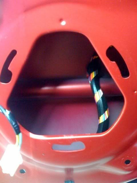

The rears are identical to the front. Here's the front.

The spacer is from Crutchfield. Just enter your car info and browse through wiring accessories. But that alone wasn't enough. As I said I had to use 1/4" of fiberboard spacers + Crutchfield spacer.
Alternatives would be to use the stock speaker mount and cut out the speaker. Or saw into the door and make that triangle a circle. I would like to see someone do the latter!!
Edit: I forgot I had these pics from the drivers side.
