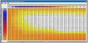

Here are my mivec maps. Try at your own risk! Make sure to log AFR, Boost, and knock and adjust accordingly. this map should lower you're boost so adjust it back to where it was. Report back your findings. It is still a work in progress.
This originally started as the intake map that Bryan posted. I created how it is now by comparing to other maps, HIboost, JDM, Gunzo, and also the help I got from Pete at DG.
The exhaust map is close to HiBoost's map but with my topend settings.

Old Jul 30, 2009 | 12:33 PM
BigT's Avatar
Posts: 1,029
From: NW NJ
Also, what load cells are you guys hitting? I'm seeing a max of 270ish dropping to 220 at 7k and 205 at 7.5k.
