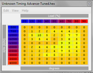

Tables that I'm looking at:
Ignition Warmup Retard - I only see 3's and 5's on this table which is much more than 11* to as much as 30* being pulled.
EGR Timing Advance - This table is very uneven but as far as I can tell the effected load % cells would be advancing timing between 5*- 7* in the 2500-3000 range, not retarding it!
Evap Map #1 - This table is leaning things out to a target 18-19.8 AFR from 2500-3500 during warmup presumably. Gave me a nice scare when I was testing lean burn in open loop but I'm not sure this is the timing retard culprit.
Anyone getting similar behaviour or can suggest where to adjust first? What are the functions of these 3 maps since they are not always in play?

Yea the current warmup map is incorrect or defined incorrectly. I messed around with it a bit last year and it didn't do much.
On the 8 and 9 the ignition warm up tables have -20 to -30* in same places, from 10 to around 90 load. The 8 and 9 can have the same issue you are describing, even more so with E85, turning off the warmup tables helps a ton.

That makes a ton more sense in what I am seeing then, we just need to turn up the appropriate Evo X table then. I would imagine that leaving some retard in there is fine (and safer?), it just needs to be a little less intrusive though. The way it is now it almost doesn't encourage light throttle, you just want to get into low boost moderate throttle to avoid that area. I suspect it's an emmisions thing for heating up the cat earlier, which may or may not make a difference depending on how high flow your cat is. Cough... cough...
HB Speed:
I think that table you posted is just the EGR Timing Advance table. I tried smoothing it out a bit so there weren't so many huge timing swing but since I can't tell when it kicks in it's going to be hard to test any difference.
HB Speed:
