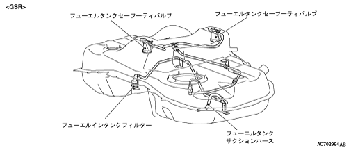

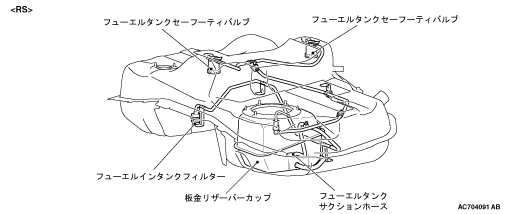

Originally Posted by TTP Engineering
A surge tank is really not the end all answer if the fuel flow from which it is fed from is lacking. It can help in cornering, however there some upgrades that need to be made in the rest of the system.
Honestly, I would like to see the RS tank performing better with documented results. I don't quite see much of the benefits in tank design. It appears the area under the bucket assembly it a little lower but how does that equate to results if the siphon from the passenger side is one of the main issues.
An article from AMS explains how the siphon works. In Tephra or SiC's post a page or two back, one can see the silver siphon tube from the in tank photos of the RS and GSR tanks. This is where the problem lies, at least on the dyno but possibly also in everyday use also.
I'm not really aware of the siphon problem but here's a skeleon view of the RS & stadard tank. You can see it basically has a collector or surge tank (Mitsubishi calls it a reserve tank) built right in it but it still has the same siphon setup. The capacity of the RS version is 5 liters smaller (little more than 1 gallon) and the price is around $500 USD here.
Now we are getting somewhere, this is informative!
