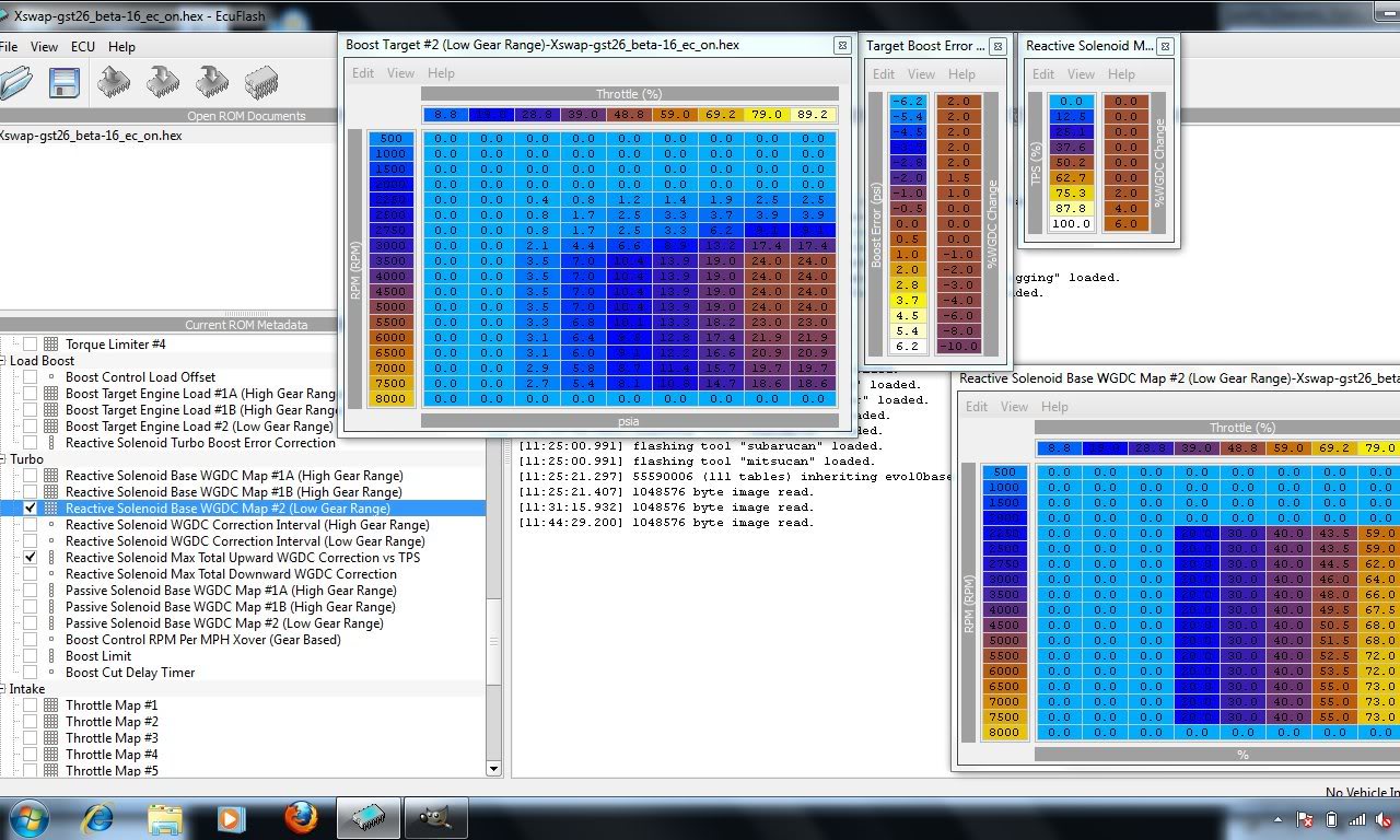

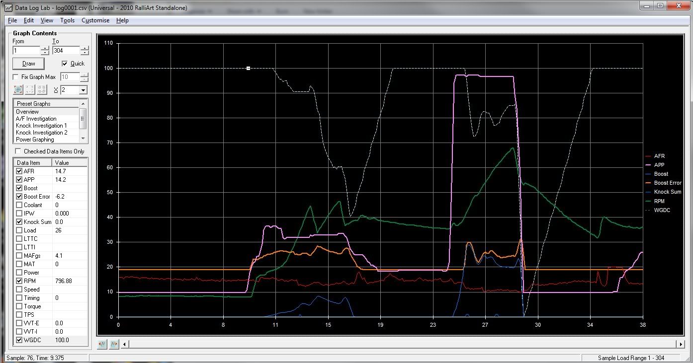

So, i noticed today a possible error in the PSI boost logic for the 2010 RA Roms (55590006) but it may actually be a logic error in how the boost error is calculated in general..
What i noticed is any time you are running in vacume the boost error is reported at - vacume reading so if you are running 20% tps at 6psi vacume and your boost target table is set to zero at that point your boost error is -6psi which causes the wgdc to ramp all the way to 100% even if the max upward correction is zero at that tps setting.....
log
map log was taken from
In the past i did not see this if the larger boost error table values were set to zero... so lets say the boost error table is set to zero above -2.0 psi the duty cycle would remain at zero...
So, either the max upward correction cap does not work, or the logic behind the wgdc correction routine is flawed or a combination of the two.

Looks like you logged APP, not TPS.
But still, 20% is low.
Yup app, but you can still see the duty cycle shooting up to 100% with my foot off the gas completely.... while the max upward correction table is zero up to 75% throttle...

Originally Posted by rrkpitt15
Does it really matter tho what the boost control does in vacuum or at low boost? Your wastegate wont be able to open until you reach a minimum pressure that the WGA spring is rated at.
I'll put it this way... with error correction off that duty cycle map was getting me a peak of 22 - 23 psi... with error correction on and duty cycle going to 100% BEFORE i ever went wot... I was spiking 28 - 29psi.
Rich pointed out the issue may be to do with the scale values of -6.2 and +6.2 on the boost error correction table, these are out of bounds and may be causing the strange behavior... more info latter on after i test.
