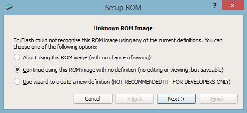

I updated it this is my log now. I can't edit my cars SRF file anymore. I get this error.

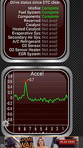

I figured out, before I updated, that the OBD Inspection Directory "Monitor Passed(1)/Failed(0) Read Only, Do NOT Change." all things are set to pass(0) but the directory before it "Monitor Available(1)/Not Available(0) Read Only, Do NOT Change." are all set to "0".
I assume this is my issue. I could change the value to "1" aka "available" but i cannt save the file to flash to my car. Every time I save and replace existing file its fine then I try to close EcuFLash it tells me i ve changed a file and need to save the changes and the cycle continues.
issue 1 definition for my SRF file and afterwards saving the rom SRF file...
issue 2 saving the changes...
thanks in advance.
Attached Thumbnails Emissions check OBD Error - help-emissions-unsupported.jpg

Post up the error'd out srf file to see if the rom id is different, also make sure that it's set for the Evo x not another one. Have you updated to the newest ecuflash also?
Last, do not change that table, it's apparently a stupid way just to show the info, and If you change it, things can go bad fast. The passed should all be 0's to pass, availability should be a mix

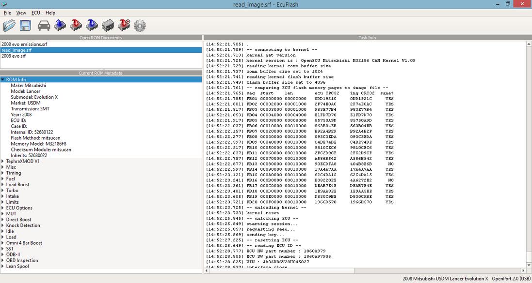

I think this is what you're looking for.

No I wanted the actual file its self. If the forum wont let you upload it, PM me and i'll send you my email adress

there ya go, sorry
