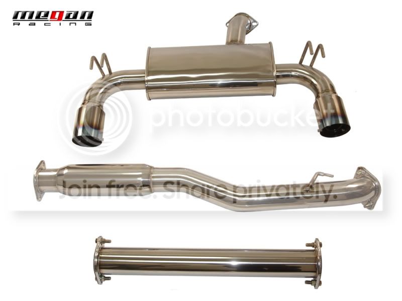

I don't know where you guys got your info from... this is most definitely stainless.
As far as quality, it's all stainless with good welds. An exhaust system is just a bunch of piping, a couple flanges and a muffler. As long as it fits properly, it's pretty hard to mess up.

There are different stainless steel alloys ... it's probably 409 instead of 304. That would make it cheaper.

^^Very true. Easy way to tell....stick a magnet to one of the pipes. If the pipe is magnetic, it's 409. If it's not magnetic at all, it's a 300 series stainless, probably 304.
That being said, I have a stainless Megan Racing muffler on my other car and it's not magnetic.

409 is made from primarily from iron/chromium, 304 is similar but also uses nickel. 304 has better resistance to heat and corrosion but costs more.
