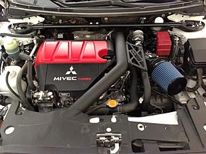

Fitment Issues
I installed the UICP per Cobb's instructions but now I am having leak issues. Is this just me?

Check the smallest T bolt clamp on the turbo outlet to see if it is bottomed out

Figured id chime in..
I quite enjoy the hard pipe kit! everything works great and the boost came on 200rpm sooner. not that i have a way to prove it but that's what i noticed.
when i first installed the kit i got a leak from the turbo outlet side (uicp) the Tbolt that came with the kit was too large and had to buy a new smaller bolt.
everything else worked great.
here's a look of the finished product.. note i'm using stock air box still.

Final product installed.

Can you not use the factory snorkel on the cobb intake?
Snorkel?
are you talking about the factory air box? and yes you can. you just have to use a dremel to sand down some plastic on the air box.
or are you talking about the cobb inlet hose? it's a factory fitting hose.. you can use the SF filter kit or the factory air box with the hose.
