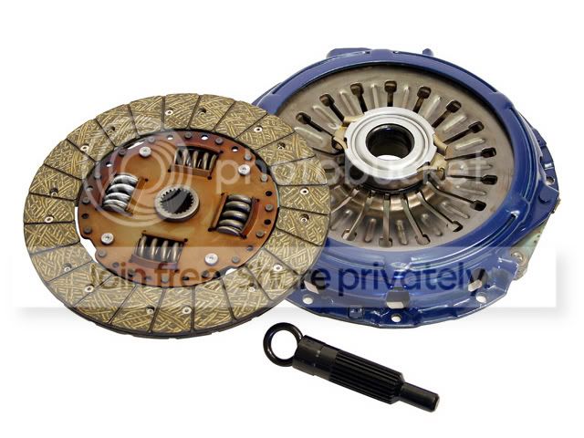

Magnus CMC with a Spec 3+ clutch and youre set, bunch of people are running the spec 3+ clutch, even i myself and love it
