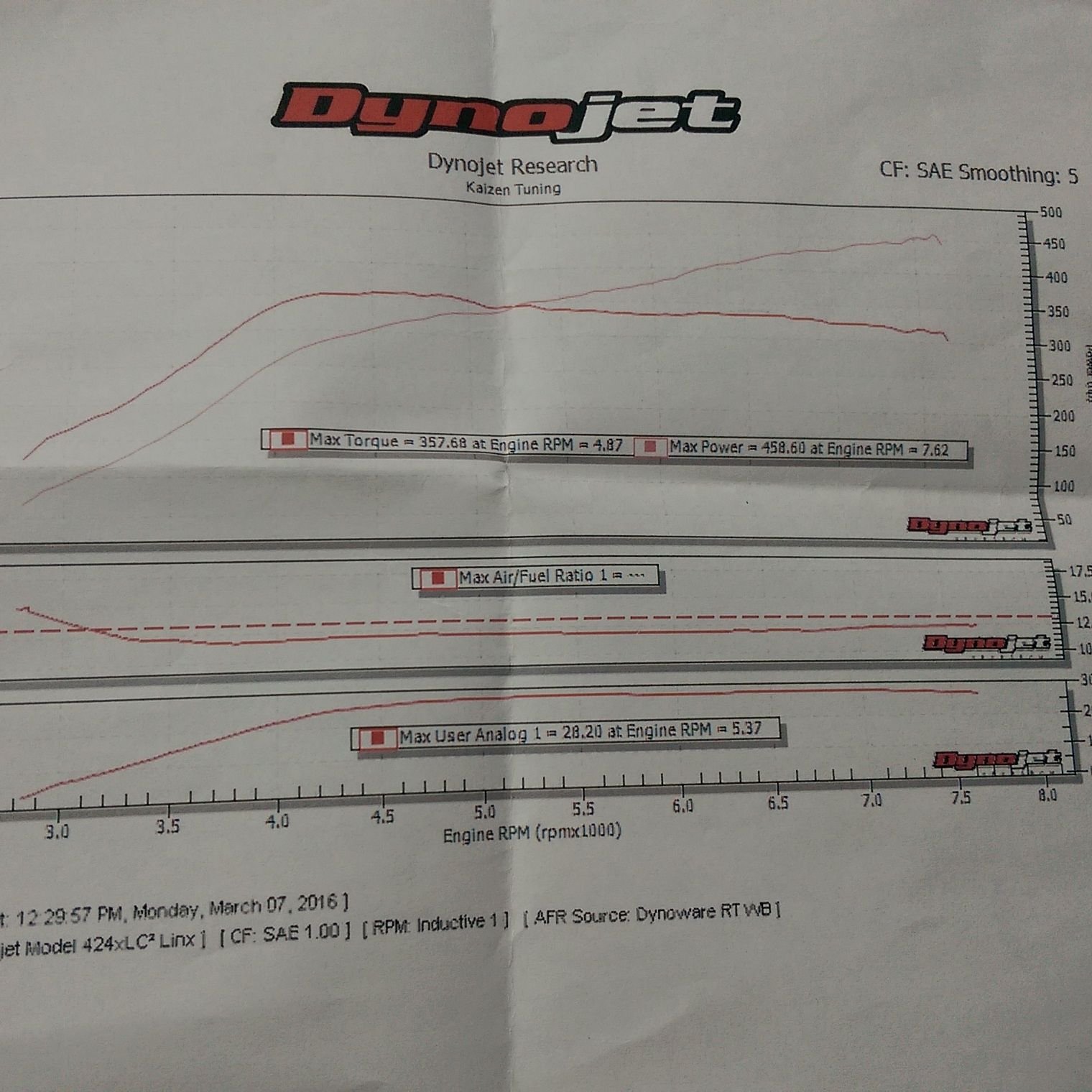

458hp 357ftlbs @ the wheels.. tuned by rob @ kaizen

Did you go with a welded on elbow or silicone? Also was the turbine housing sourced from ATP ? That dyno plot is amazing. 200lb-ft on or under 3,500 rpm AND making basically 460hp at the wheels is a frigging perfect setup.

Hey man thanks! I'm very happy with it... As far as the elbow... Turbo comes with a 90 degree 2 to 2.5 in silocone coupler for the outlet... So I used that. And for the inlet got a 4 inch to 3.5 inch 45 degree silicone coupler... All seems to be working fine!
