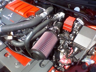

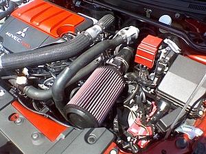

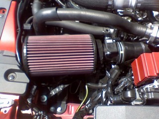

CAI install..GPS/Sirius install
Thought I would share my setup on the CAI and my GPS and Sirius..Its a different car with this on there..I went for a nice clean look..I also ran under the console an Ipod cable to the center console and an extra outlet for my cell phone..I ran 3 outlets in total plus the one from the factory..

Thanks..Yea I wanted a clean look and had to make use of the space..I will take some night shots tonight and post..Its a megellan 4250 which I got at a steal for 260 shipped..Retails for like 500..I had to use the satelite mount with the GPS holder to make this work..I will work on more pics..Also I plan on making a 3 gauge cluster with an aftermarket radio..I want to set them on an angle so I will probably use fiberglass or body filler..I am going to try and paint the same color as the OEM piece..

Whatever you want to name it I will tell you what ITS BADA$$..The car pulls and was the best mod I guess you can say for now..On the weekend I will probably make a heat shield for this and still will cost me under about 125 for everything..I am itchin to make the gauge cluster set up..Thats coming pretty soon..

I got the filter at PepBoys 59.99..Also I need to get a 2 rubber cuplers to make this fit on the mass air..You need a 3" and a 2"..I also bought 2 pipe hangers to make the bracket..Dam I should have took pics of before and after..It was getting dark out and tried to finish to fast..

Its a K&N..Well worth the money I feel..I am telling you..If you put this set up on your car you wouldnt think twice about the $$

Defiantely not a CAI, in fact, it's sucking in more hot air now that there's no box around the filter. There is a vendor making one out of Polycarbonate I believe, using the factory snorkel. Can't remember who it was, but a little searching can find the answer.

yeah this filter looks too long to use the factory snorkel
