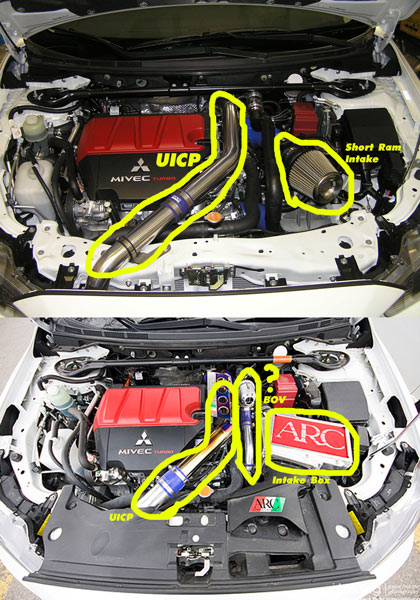

ok, i've been trying to educate myself on the mods that will benefit my MR.
couple of things i want to clarify...
CAI vs. SRI: which is safer for the car? i take it hydrolock isn't an issue with short ram intakes? but SRI is not as beneficial in terms of power. in the 2nd engine bay pic, there's an intake box. is this just a shielded CAI to keep the moisture/heat out? i'm also confused about drop-in filters. where is it located? it's not the same as the SRI right?
UICP: is this really needed? other than looks, what are the benefits of aftermarket UICP without being paired to an aftermarket intercooler?
BOV/wastegate: when is this necessary? upgraded turbos or increased pressure from turbos resulting from aggressive tune?
say i go for a CBE+UICP+SRI + Cobb AP tune (does not register on ECU right?) what kind of power gains should i expect? i hear many people suggest the SST tranny shouldn't be going over 320 lbs/ft torque at the wheels and 350 awhp if you want to keep it safe. what are those numbers at the crank? that's how mitsu state their specs right? 400hp/380 torque?
MR is my DD and i don't plan on tracking, so i think those numbers will be more than enough. hell, i'm happy with stock power right now! i think stock makes something like 230 awhp and 250 torques? with all the additional power from those mods, i should be expecting resistance from dealer regarding warranty right...even those that are considered mod friendly?
thanks for the help guys.

I wouldnt worry about getting an Intake, just get a aftermarket panel filter it will be more than you need.
The UICP helps even with a stock IC. Its one of the basic mods everyone does.
BOV isnt necessary, the stock recirc is perfectly fine. Get a forge wastegate actuator, it lets you hold boost better up top.
I think the best route for you is the basic mods:
Panel filter (HKS,KN, Cosworth, Works)
UICP(Nisei,Cobb,Ams)
CBE(any)
Wastegate Actuator(Forge)
Tune
Im sure this will net you around 320whp depending on the dyno...
If you want heat soak power loss, get the SRI. If you like cleaning your air filters once a month get a CAI that mounts the air filter near the fenderwell. If you want a good intake that doesn't suffer from either problem get the AEM intake...plus Cobb now offers a free tune to support it.
The stock UICP will "balloon" under high boost...hence power loss. An aftermarket metal UICP will not balloon.
Let me stop you right there. You don't need an aftermarket BOV for your application. Keep the stock one.
As stated before:
1) Intake (AEM makes a good one)
2) Cobb AccessPort - Stage 1
3) Cat-back exhaust
Old Jun 1, 2009 | 12:12 PM
