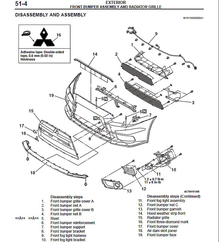

Think it's part of the radiator grille but I don't have the part number. See pic for reference.
