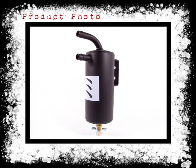

I attached photos of the can set up I am going to go with as well as an exploded view for people to take a look at. It's design is the best I have seen thus far and at a decent price. I just need to pic up some check valves for the install.
Attached Thumbnails probably a stupid question...-catch-can.jpg   probably a stupid question...-detail.jpg
