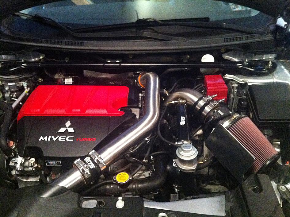

I spent the my day saturday putting on all my ETS parts that I ordered for myself as a Xmas gift. I got the intake, upper and lower IC piping and 4" front mount (back ordered untill mid january) as well as the recirc downpipe and test pipe.
Install went smooth and fitment could not be nicer. Fits like OEM if not better. I was worried about all the horror stories about removing the turbo oultet and what a PITA it was to get to the nut on the stud, so thats where I started. I did remove the strut brace and WG actuator, but after that all I need was the box end of a 14mm craftman wrench, THATS IT. Maybe I was lucky, but I was in good spirits when it came right off.
Here is a photo of the end results, I love the brushed stainless look.
Big thanks to ETS for exceptional products and stellar customer service!

Congrats!! Was pain when I was doing my AMS downpipe but the rest was cake

Engine Bay looks clean. Very nice
