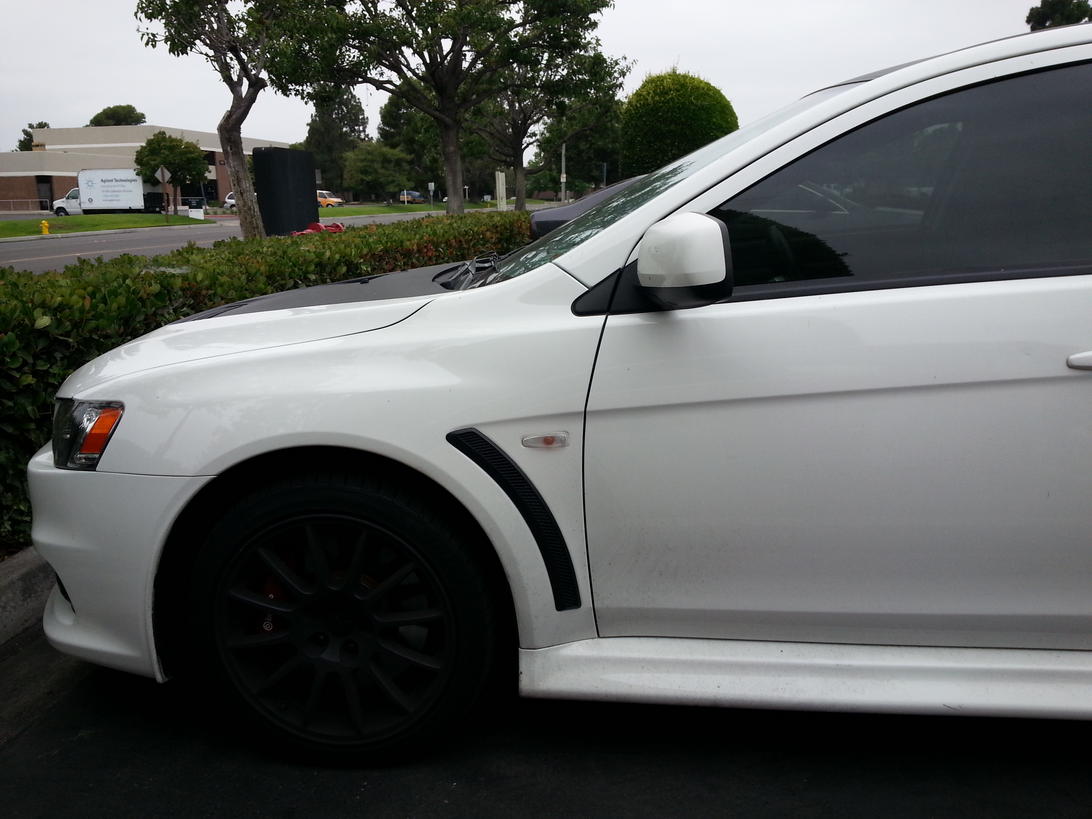

Nows the time... I've wanted an evo since I was a wee child, now I can finally afford one at 25. I was an sti fan for awhile but then my friend let me drive his evo and it pretty much sold me. 2011 evo x gsr 23000 miles.
Any tips on next step performance mod? Currently its running a MXP DP test pipe, exhaust a Stage 2 Competition clutch and an intake )not sure if its cai or what) How can I fix this rattlirattling is it really the test pipe? Posting pics soon
(cars *** is so big it too me 5 tries to get it to attach)

Get a testpipe with a bend in it, straight testpipes are known to rattle.
Is the car tuned yet?

Straight testpipes rattle on one of the driveshaft mounts, curved ones bend away from this just like the factory cat pipe does.
