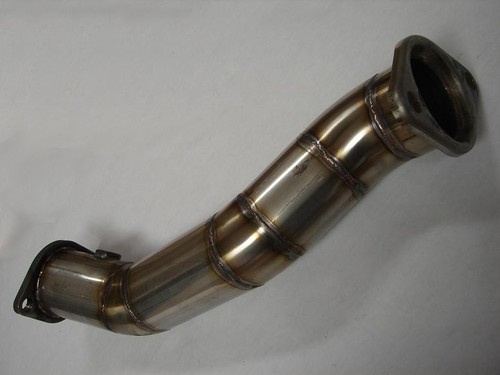

Here is where the confusion comes in. I think it might be possible that we are all talking about 2 different parts. Based on the diagram labels on a website (www.evoxservicemanual.co.uk/) the down pipe is just that. The pipe that runs down from the turbo and connects to the cat on the other end. There are two spring bolts on each end holding it in place and it has one bung for the forward O2 sensor. The O2 housing is the part that connects the down pipe to the turbo. It's short, wide mouth and has 6 bolts (I think) facing towards the passenger side of the car.
When you purchase (what some of the vendors call) an upgraded down pipe. Some of them come with the O2 housing already attached to the end. It's sold as 1 unit but could be called 2 different pieces.
I was looking for any tricks to getting to the drivers side spring bolt on the down pipe since it's obstructed by the drive shaft.
Attached Thumbnails Evo x downpipe removal-down-pipe.jpg   Evo x downpipe removal-o2-housing.jpg   Evo x downpipe removal-both.jpg
