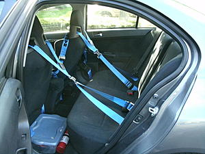

Get a 3 point harness? Heel2toe said traditional 3point seat belt (the belt that comes stock with the car. As for a 4 or 5 point harnesses:
A 4 point harness can be used with your stock seats whrere the lower 2 belts connect to lower mounts on the floor (sorry that may have been obvious) which I believe can use the stock mounting points but heel2toe should confirm. The upper two belts pass through the openings in our seats and can be either set up to srtap to a harness bar (auto-x)/roll cage crossbar (technically should only be a race only vehicle) or can be mounted to canhor points somewhere in the back seat location. This mounting method should be within the correct belt angle described in the installation manual for that harness (typically no more than around 15deg below horizontal from the seat pass through) though many people anchor them to the rear seat buckle anchor points that come stock (read: probably doesn't meet the harness manufacturer's angle requirement to provide the right level of protection but is cheaper than doing it the right way)
A 5 point harness has an additional single vertical strap that passes between the legs and is mounted to the floor. This requires a seat with a slit or slot to accept the belt and likely (not positive on this) a fixed position seat to ensure the proper belt angles. This is typically used during real track driving and is likely required in a race series.

For a 4 point, yes but it may not meet the manufactuerers standards in provide the right level of safety. It may actually be more dangerous. A harness bar, high mounted rear seat mounting points or bolt in roll cage are desireable mounting options. Just specify how you want to mount them during the ordering process so the company sends you long enough belts or with the right mounting point attachments.

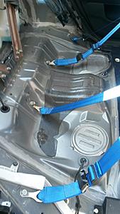

I have been using the Schroth ASM 4 point in both the Evos for years at the AX and Track. I have had some issues with some of the tech peoples at different venues not accepting the 4-point but they are DOT approved. Without installing a cage or roll bar in the car the Schroth harness is the better option for securing the driver compared to the factory belts. I.M.O. But I haven't had the pleasure of testing crash results

As with Peter's example the ASM acronym is "Anti Submarining" tech, which is a system Schroth uses which allows a 4 pt to be used at more extreme mount angles and not be as dangerou. They are saying you can mount them to the stock locations and it is fine. This tech is proprietary and is an exception to the norm. You can read about it at schrothracing's webiste. Im not sure if Willans, Takata or any others have a system for this yet. There are also differeneces in street/DOT legal and for off road use only in the buckle latching system so ensure that also meets the uses for your car. An EMT responding to your overturned car (God forbid) needs to be able to instinctively unlatch the buckle. The expectation is that the latch has a clearly identified (colored and labeled) button style unlatching device.

Now I guess I am sorta a hypocrite as Im just using my harnesses in conjunction with a harness bar but this is solely for auto-x. I would never use them on the street or on track as I don't feel it is safe. Once I start tracking my car I will invest if a complete safety system as that is the smart and wise thing to do. But remember I didn't invest in my harnesses to keep me safe while autocrossing but rather to keep me strapped in my seat.
