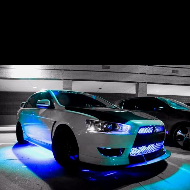

So does streetglow

How much does this add

500 whp at least.
I can't lie though it is a bit much but doesnt look all bad. (puts on flame suit)
