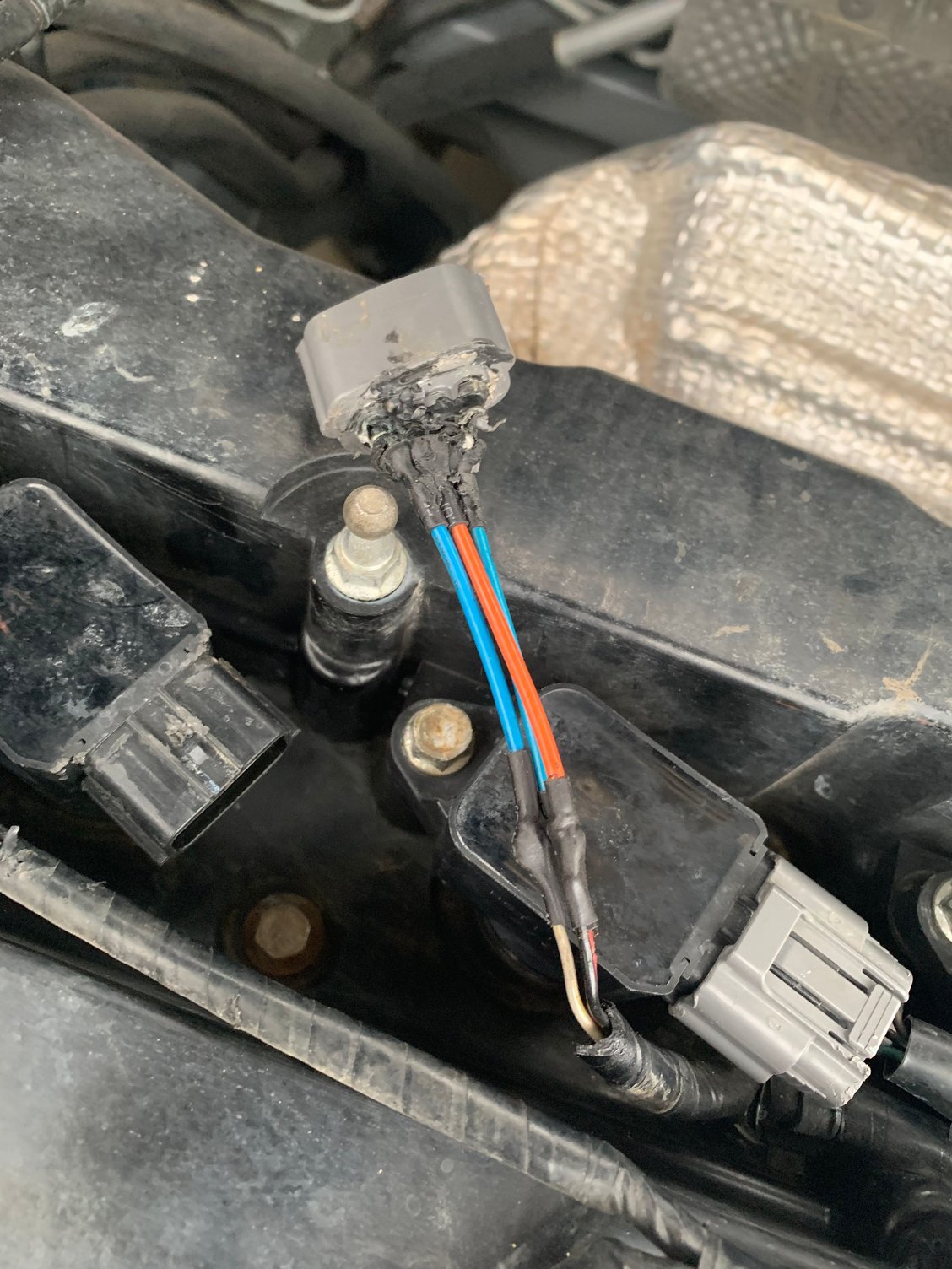

I as well had a bad wire that someone tried to fix and did a horrible job at it so I’m thinking of doing the same as you. The pics below are how it currently is and I’m replacing it with the alt. Connector
