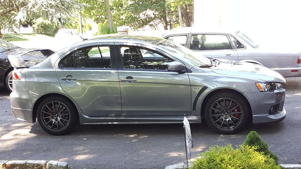

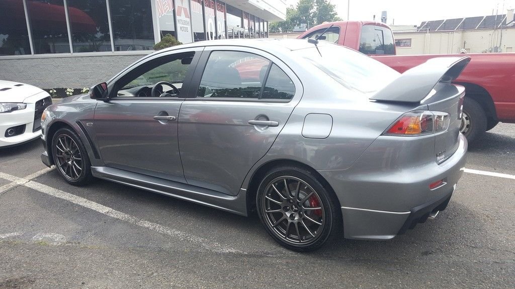

I just picked up a new final edition evo and I couldn't be happier with it. I leased it for 3 years so what ever mods I do to it must be reversible (I may or may not keep it) and I can't push crazy numbers but that's fine by me since I don't want this car to be that insane. I know modding leased vehicles is not the best choice but I'm going to do it anyway.
I've done a decent amount of research for mods but can someone tell me what else I need for this setup? I may either do a full ets exhaust with an open dump + quiet muffler or just keep the stock dp and just do the v2 regular exhaust since the DP may be stupid since I am keeping the turbo and turbo manifold stock. I am also going with the ETS intake. The turbo smart bov seems like a popular choice as well. This is my first turbo car so I'm not sure if I would need the Tactrix or cobb ap. I do want to get this car pro tuned at IveyTune so it doesn't blow up. I was considering an off the shelf e tune but I'm assuming a pro tune is better for obvious reasons. Is there anything else I should look into? Is it easy to re flash the ecu back to stock if or when I trade it in? Posting on the forums is my last resort since I think I can't find any more info out on my own. Sorry for being a noob and not knowing much about turbo'd cars but I don't want to mess this car up lol.
I'm going to daily drive this car so how crazy would the ets open dump be on this car? Does it open up whenever I have my foot down a lot and boost comes on? Or is it just always around 3k no matter how easy im taking it?
As for the car, it's a final edition with the exterior aero kit and the optional strut bar. 40k later..

Looks good!
Bang for buck-wise, you really don't need to replace your downpipe. Gains just aren't there on the stock turbo. Go for a pro-tune by Ivey via opensource, unless you really want an AP for some reason or another.
Also yes, you can easily get it flashed to stock when you go to trade in, via either opensource or AP (whichever you opt to use).

Looks good! I Almost got a Final Edition, but i ended up with a ww 2014 GSR with all the goodies 👌

Nice fe rims
