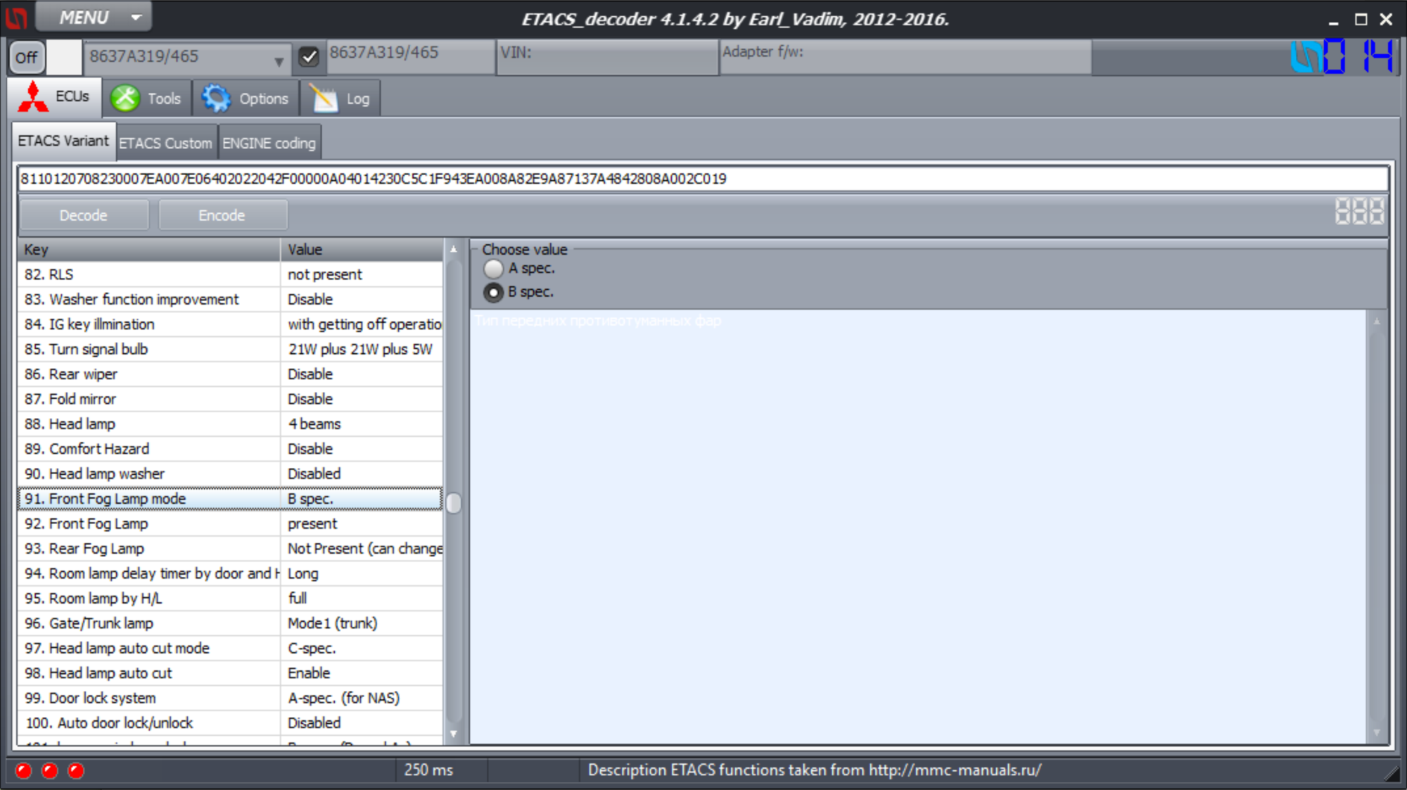

Sure thing. You'll need to make an account on the ETACS Decoder Forums first. Then go ahead and download the program.
Make sure your Tactrix is plugged into your computer and car, then open the program. Sign in and flick the switch at the top left to "connect" to your car. Once it connects, click on decode so it can grab all your current settings. You'll want to scroll down to where it says "Front Fog Lamp Mode" and switch it to "B Spec" I believe it was. Then Encode and Write to ETACS. After your restart your car you should be able to use fogs independent of low beams. You will need to have the headlight switch set to the middle option that turns the side markers on. The program is a little finicky so you might have to play around with it.
