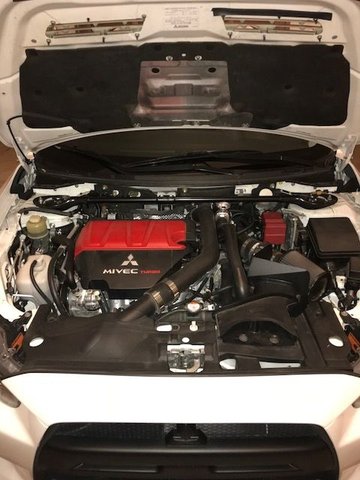

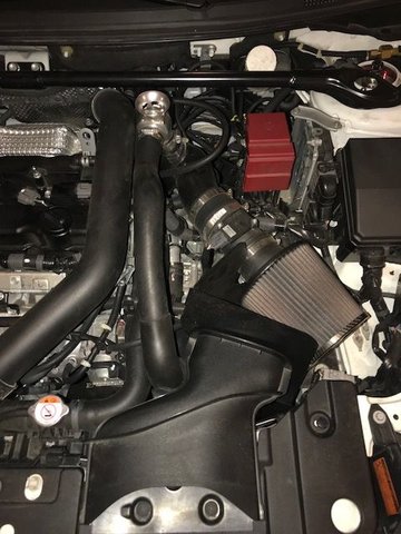

Here is a current picture of my setup. Pretty standard?

that is funneling water right into your intake from the fender. In heavy front rain I don't see how that isn't soaking your air filter and making water pool in the bottom of the cone. I had a drop in Cosworth filter for my tune, never an issue in the rain, roughly same gains. Dunno, that's pretty wide open imo
From the fender? What??
This is definitely not the case. The intake has never been wet after driving through rain, and there has never been any water pooling anywhere.
There are thousands of evos that have their intake setup the same as I and have no issues. Water is getting somewhere else.
