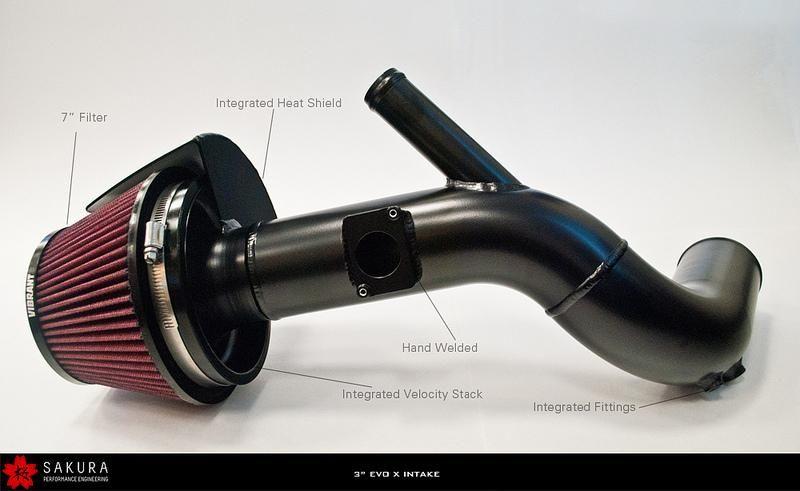

I noticed your intake doesn’t have a shield to protect it from Air coming off that radiator fan. I’ve read issues associated with not having a shield. The shield, sold with many aftermarket intakes, protects the filter from hot air when the AC is running.... This is just a thought since you’re issue occurs once the vehicle is warmed up. Maybe look into purchasing a shield or see if someone local can loan you one to try.

The intake is a Sakura intake and it does have a heat shield on the bottom.
