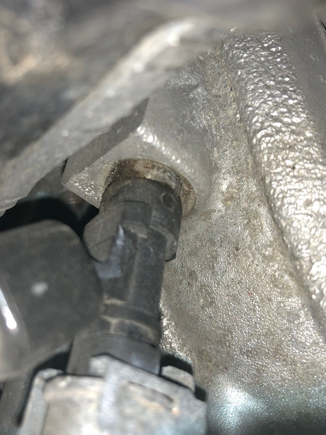

also if anyone knows if these injectors are stock or 1000s?
